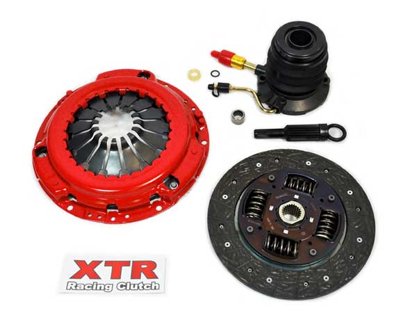

I can get a XTR STAGE 1 CLUTCH KIT+SLAVE CYL w/ throw out bearing that come with a 9 1/8 Full Face Organic disc is resistant to slippage and burst. For $147.20 w/free shipping

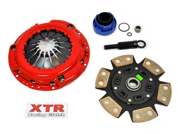

Or the XTR RACING STAGE 3 CLUTCH KIT SET w/o slave ,but comes with new throw out bearing & is 8 7/8 6-puck Copper Ceramic (also known as MIBA) disc features high-coefficient friction pads that are resistant to slippage and burst. For $139.94 w/ free shipping
both kits come with pressure plate, alignment tool & pilot bearing.

Stage 1 should be sufficient. Honestly id get a luk pro gold.

I have a napa LUK in mine, works flawless on locked 4.56 axles with 35 boggers, never once had a slip in mud. Only had dirt wedge the pressure plate teeth so it wouldnt rest against the flywheel.
like others have said go with the luk.
racing clutches are not made for long term use and would most likely wear out sooner then later.. just my 2 cents
I went aftermarket when I put the clutch in my F-150. I forget the brand but IIRC it was a Stage 1 or 2 clutch. Never had an issue with it slipping and I've put over 40k on it now. The problem I've had is that it's so sticky it's hard to slip the clutch at times when you need to. It just wants to grab and go and my mighty 300 straight six just doesn't seem to have the go to overcome that and let it slip. So I'm on the fence about getting a stickier clutch without having a lot of ponies running loose under the hood.
Go with the centerforce stock replacement friction disk and the centerforce pressure plate with the weights (you have to buy them separately I believe... that's how I got them), that's what I did and have absolutely no regrets, that thing is sticky... don't go with the puck style clutches as I hear bad things about them driveability wise where this setup is a perfect balance in my book... I was having the same mileage on the luc clutches lasting around 2 years...
