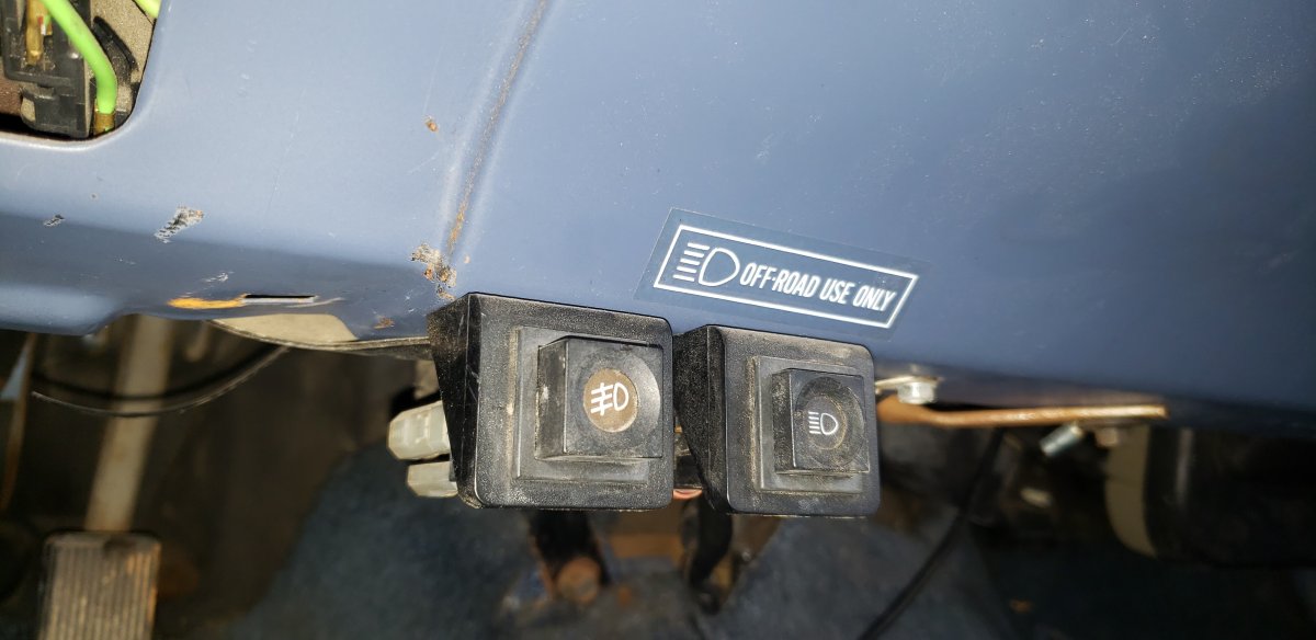

Can someone repost the Gen I switches? Or confirm / debunk these?20210118_140710.jpg

Can someone repost the Gen I switches? Or confirm / debunk these?View attachment 54416

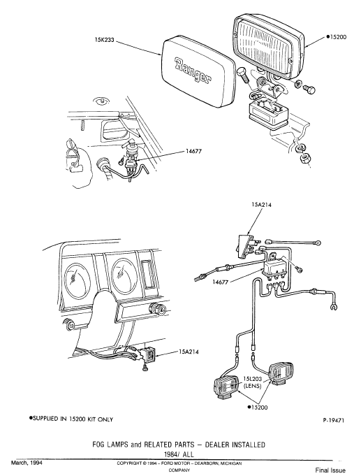

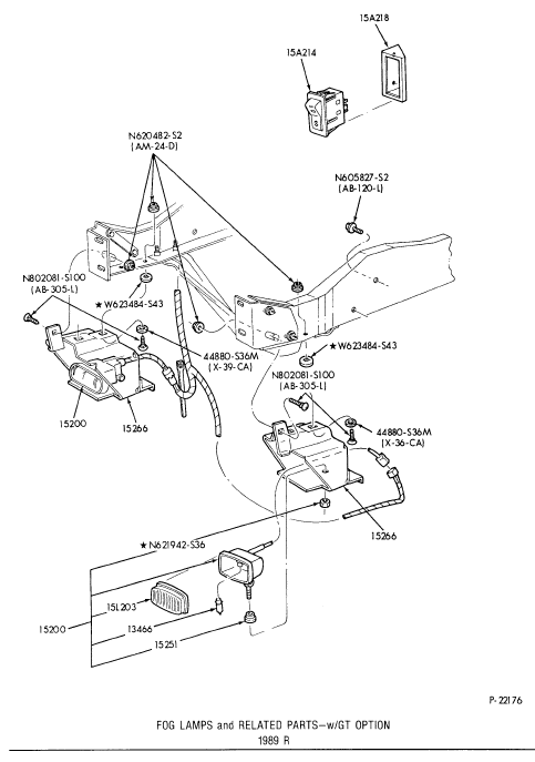

What I see in my parts book:
Play minehunter with the prefix (something like E3TZ and then the number in the pic and you might turn up something. Play with the number, the 3 in E3TZ means it was designed in '83, so if it was updated in '84 it would be an E4TZ etc. BUT if it wasn't designed for the Ranger it might not be TZ... the joy of Ford part numbers. If you need help don't keep it to yourself :icon_thumby:
I can confirm that my '88 STX has the same sticker in the same spot, but a one piece switch bracket. The switches were gone when I got the truck. I'd say yours are legit Ford parts.
