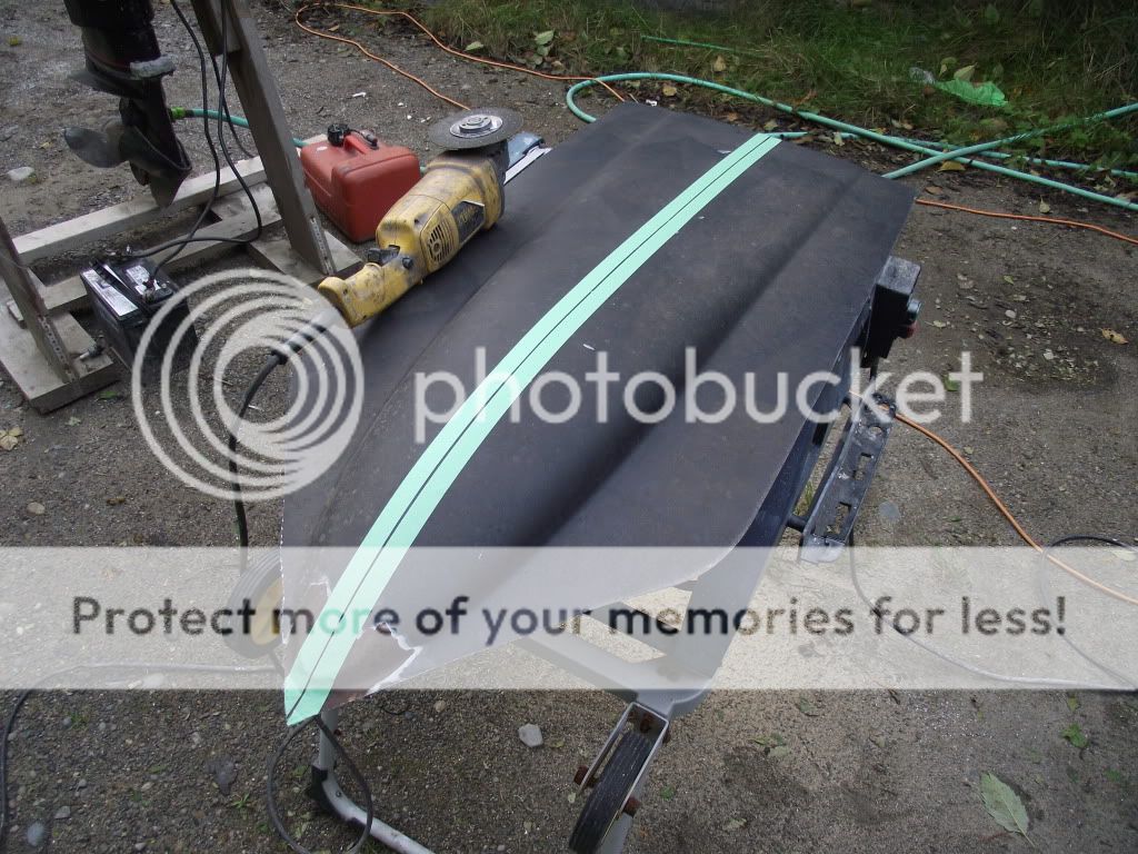

time to deal with the bulge...
marked for cutting.

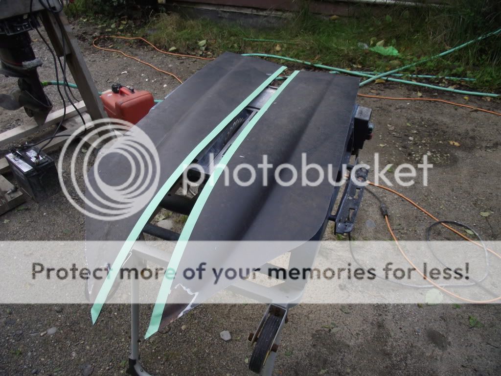

and split.

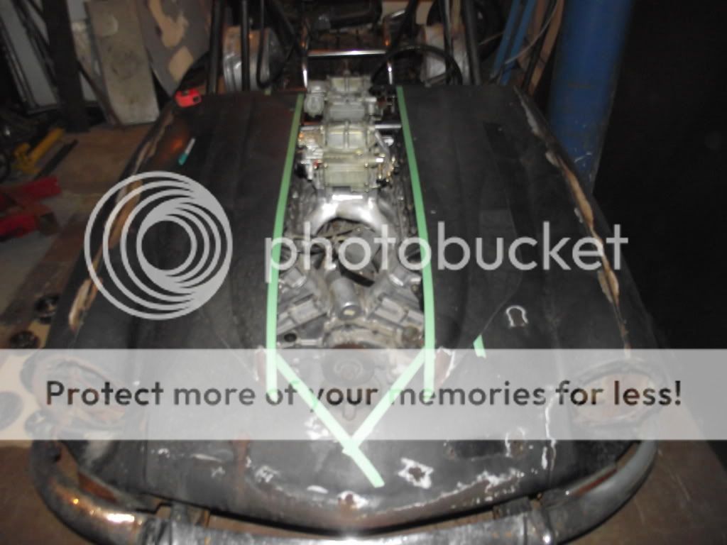

set in place to see if this idea will work...
looks like it will.

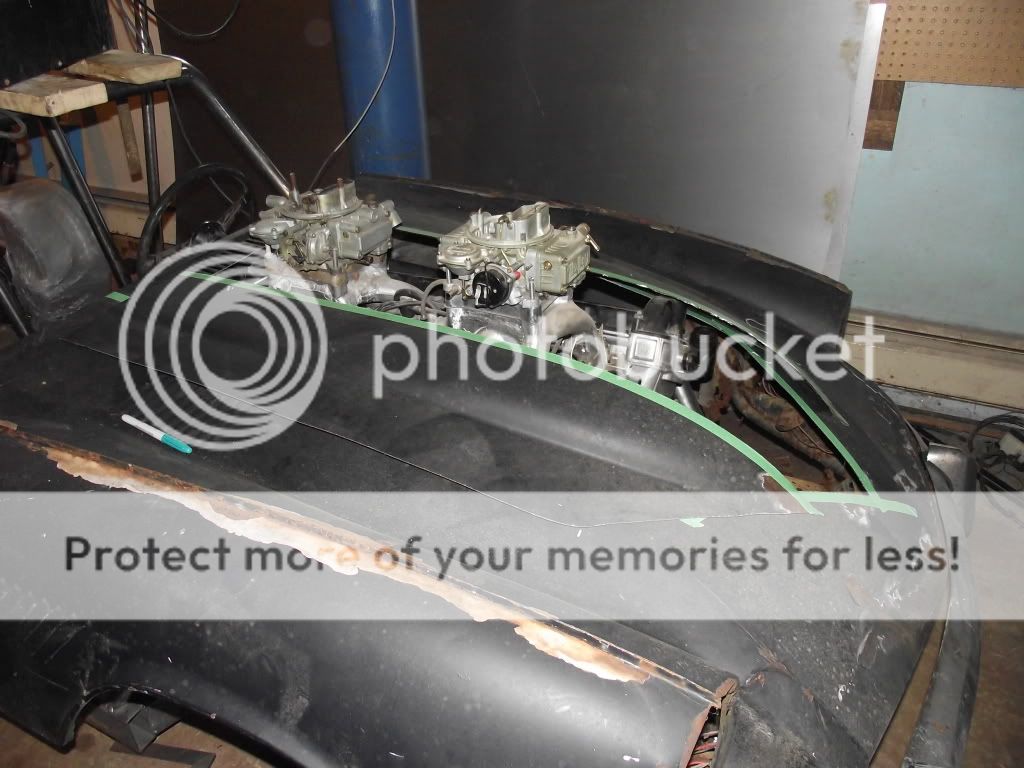

to cover the big opening in the front i'll have to build a panel from scratch.
brother, I would do something to raise it just a little higher, just so you dont get rattle from the hood being too close to the covers.
this is just the rough concept stage,of course.i'll give it about 3/8'' clearance.i don't want too much,but everything will be mounted tight enough that i think that will keep it from contacting.
