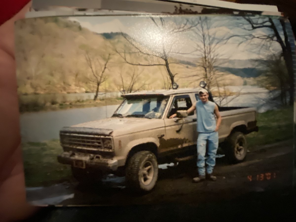

Hello, I'm getting an 88 Ranger like my first vehicle with a great body but is 2wd and want to swap to a 4wd. The truck is now an automatic but want to make it a manual 4x4 with a manual transfer case. I am looking at around a 95 model or so F150 with a 5.0 for a donor vehicle but need a little guidance as I have searched but can't find the answer. I know the motor will swap over but am worried about the axels. I know they are wider than stock but what has everyone done in that case? leave them wide or go with explorer axels? I don't necessarily think wider would be bad but what about adding a lift and matching everything up with the Ranger frame? What type of lift should I go with If swapping from an F150 or explorer to a ranger? Wanting to go 35's... TIA for the help
