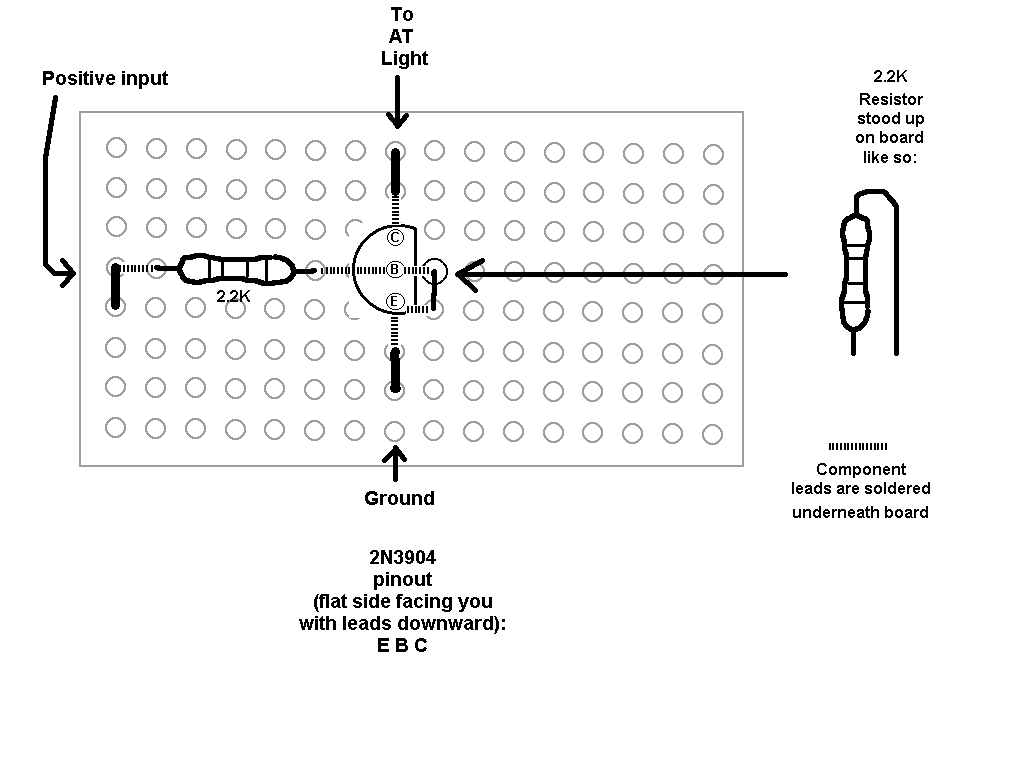

Maybe an assembly diagram can help?
Get a small board (like the one Hound posted) and put the parts into it exactly like so:
One that is done & soldered and you have attached your wires to it, use a piece of large heat-shrink tubing (1" or 1½", perhaps, or electrical tape can work too) to insulate it from it's surroundings.
Hopefully maybe that'll make it a li'l easier.
Looks great and ill definitely do this idea, i do wish i would if been able to solder it to the back of the board

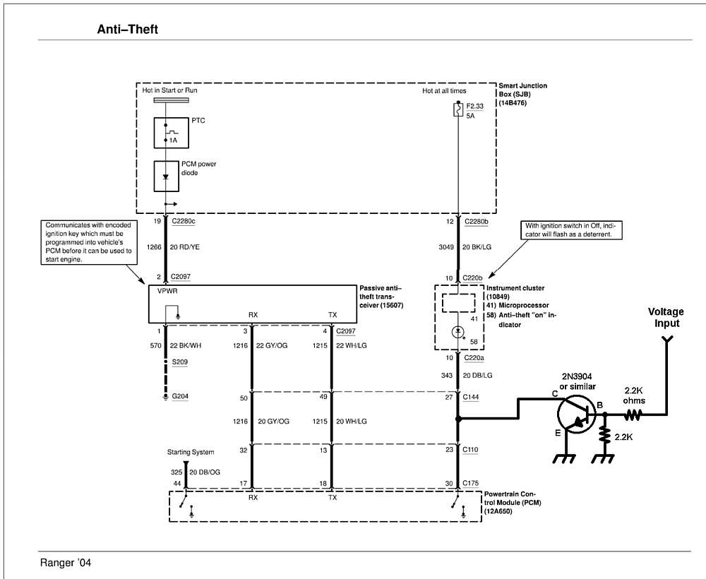

If this is the anti-theft light that constantly blinks every few seconds when the vehicle is parked, I would not suggest using a mechanical relay there (will be constantly clicking, higher battery drain).
Assuming this is a low-current circuit (looks like it should be if it's LED), a simple transistor & a couple resistors will do what you want:
When voltage is input to the transistor "base" lead through a resistor, the "collector" lead will be switched to ground at the "emitter" lead.
Almost any small NPN-type transistor will work in this circuit. 2N3904 is probably the easiest to find though. The two resistors should be 2200Ω (or 2.2K).
Note that this circuit (diagram attached) is good up to 200mA. (I suspect it'll be more around 15-20mA when it pulses, but check just to be sure)
This right here was the answer theft light works wonderfully now, thank you for the answer, hope your answer will solve other peoples problems
