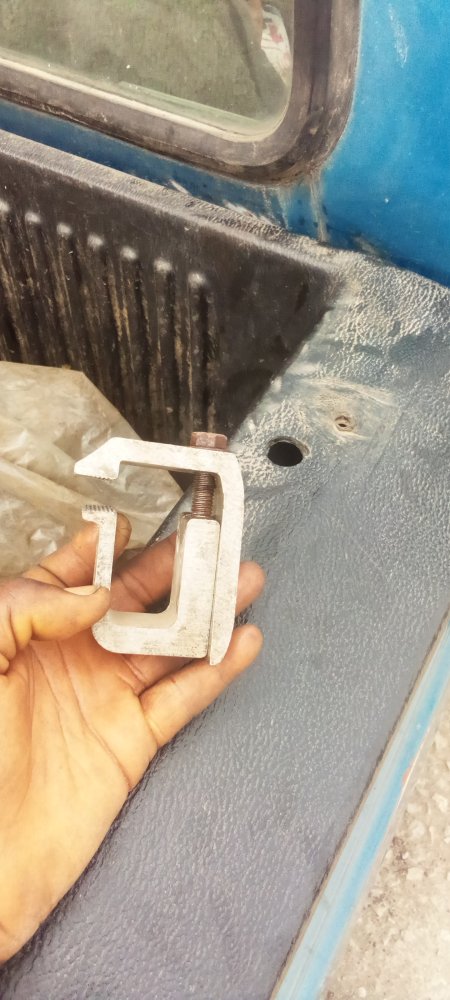

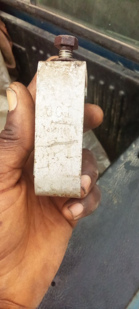

2. I have the hooks used to affix the camper shell, tp the truck rear, but i really don't know if there is a procedure involved in it's installation.

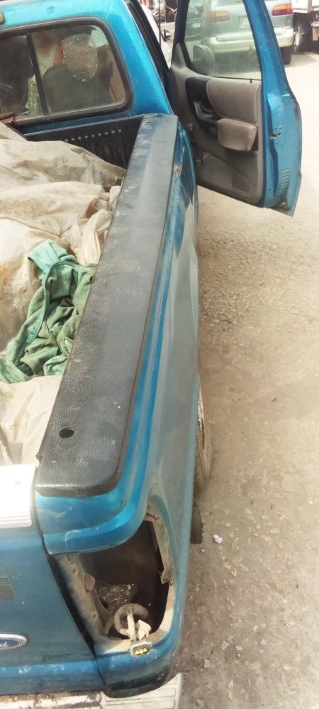

That's the truck top end where the camper shell is to be fixed
That's the hook that clamps down on the camper shell to the top of the bed
1. Transmission type is completely irrelevant. Length of the bed is all that really matters. 6ft or 7ft are the 2 bed lengths and the 7ft beds are much less common.
2. Loosen clamps, put them in place, tighten. That's the procedure.

Canopies are usually clamped to the bed at the 4 corners, clamps look like this: https://mobileimages.lowes.com/prod...4cfb-9c75-c0510e4dafe2/16729310.jpg?size=pdhi
You can put weather strip around the bed first, and put canopy on, it helps keep water and ?? out

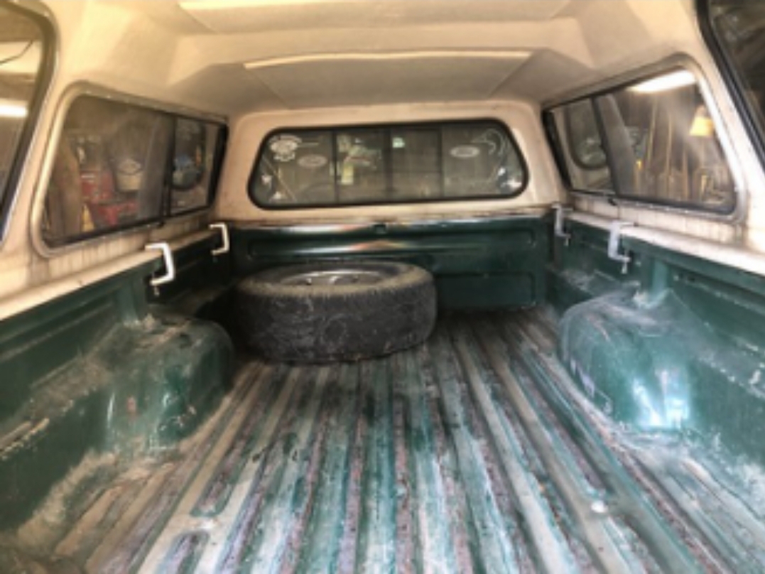

You need at least four clamps, I have 6 on mine.
The back two are not pictured.
The over the rail bedliner will need removed.
If you cut a hole in the bed liner to slide the clamps through you could probably leave the bed liner in if you wanted.
On mine the over the rail part has an airgap between it snd the top of the bed rail so there is no way to cinch it down without twisting up the topper.

yes. you probably need to take the bed liner off, or cut the top part where it goes over the edge of the bed and also little notches where the clamp will sit.
to me, its easier to get a replacement plastic bed liner than it is to get a camper shell. i would pull the bed liner out
is the picture you show of the clamp, also the truck you took the camper off? if so, you could mimic the way the bed liner is cut on that truck to make yours work, or just take that bed liner and keep your good one
Yes, it's of the clamps, and got it from a junkyard truck.
The bolts tend to gaul in the aluminum of the clamps. Apply some anti-seize on the bolt threads.
