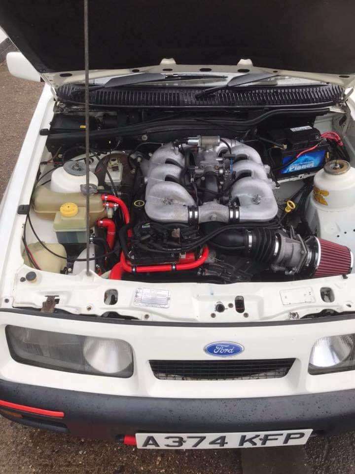

The coyote intake is dead sexy. If they'd lose the black bits and go for early style under, would be gorgeous.
Like so

RWD Taurus SHO? What makes you say that?

But it's not a SHO.
