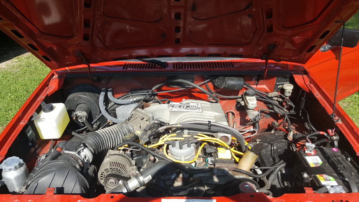

Explorer V8 or Thunderbird/SN95 Mustang would be the easiest in my opinion. The Explorer has the shortest front accessory drive parts, while the Thunderbird and SN95 Mustang has the 2nd shortest parts. I used a 92 Thunderbird 5.0 in mine (same as the SN95 5.0 engines) and it fit wonderfully. I like how the curved upper intake from the SN95 fits. They also had Cobra upper intakes in those years that were also curved.
Here's mine, though I've added A/C since this picture was taken, so it's changed a little around the heater plenum area.
Can you post a pic with the A/C setup? I've wanted to build a Bronco II and thought about using the Explorer 5.0L, but I want air conditioning because it's hot here in Texas. I was thinking that I'd have to stick with a 4.0L swap so there's still room for the heater / AC box on the firewall. I'm curious how you got it all to fit, and does the A/C do a good job if you've had to modify the blower box.
Have you checked my A/C thread?
