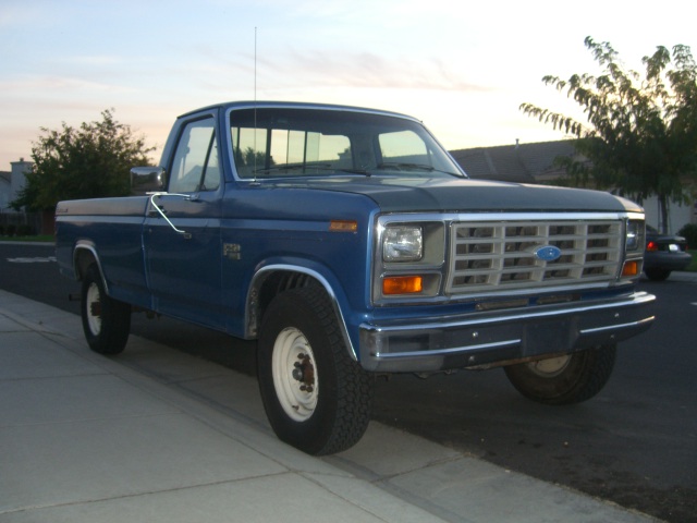

The truck in the picture does not have a 1980's cab on it.
80-86 looked like this, they played with the front clip and interior up until '96 but left the cab overall loking pretty similar:

Thats definitely a 73-79 cab in that truck. Definitely not a D60 as they only came in F-250 Sno-fighter trucks (factory snow plow package).
he says the cab has seen better days, so I'm assuming is got rust in all the usual places, floors, rear cab wall where it meets the floor, doors are probably junk, from rust and those huge mirrors.
From the pics, and the stance of the truck, I'm betting it has a 77.5-79 cab/front on a pre 77.5 "highboy chassis.
there are a few ways to identify the difference:
77.5-79 had integral PS box
highboy had a manual steering box with an assist ram.
77.5-79 chassis will not accept dual wheels on the rear dana60 without adapters 3" wide rear leafs
highboy chassis will take duals, but not recommended on the 1/2" studs
2.25" rear leafs
77.5-79 has a mated Tcase to trans. manual or auto.
highboy has a remote Tcase with 3 driveshafts.
77.5-79 has either a dana 60 open kingpin front or dana 44 open balljoint, both highpinion/Reverse cut diffs.
highboys were all low pinion/straight cut fronts, mostly drum.... 76/77 some disc brake 44 and 60s open knuckles but still straight cut gears
another thing is that on the highboys, there is a crossmember immediately behind the front bumper.
If I had more time I could think of more differences but that is probably enough :D

Oh, and I asked my father about the truck again, he said that he called the guy himself and the truck is a 79, with a 76 cab on it which is MOSTLY rust free except the top. Apparently, it has some roof rust and whatnot. He said the cab has seen better days because it is four different colors, has NO clearcoat, and is dirty and scratched.
Rust isn't a big deal if you have seen my Nissan or have seen the Dodge. I might have had pictures of my Chevy on here before.. I dunno. But my father drove that for a few years with no floor.
Bought her. Pics to come when we bring her home. If I had the money I would have bought it myself, I managed to talk the guy down to 750 with my obsessive compulsive habit of meticulously scanning fords.
She's a 1979 F250 Highboy (Had the crossmember) with rust just like I thought and some body damage and rust. It has a narrower dual wheel axle on it. The cab is from an F250 Custom, and is in decent shape for the age. Were planning on painting it Camo. Has almost new tires on it as well, but we will be replacing the front ones because they are the wrong size.
The only bad things I could see was that it doesn't have a heater, needs exhaust work but the guy had some extra stuff he through in for it, and it needs a passenger side spring hangar on the back.
Oh, and I love the bed.
If it has the crossmember right behind the front bumper its a highboy but not a 79, 73-76 had F#50 emblem on the fender and 77-79s had it on the cowl...... its probably a 76 chassis with remote mount Tcase and a 79 cab and front, that would explain a lot. if it has the 300 6cyl, it will be 4.10 ratios or even 4.56 so you lucked out with offroad gearing.
