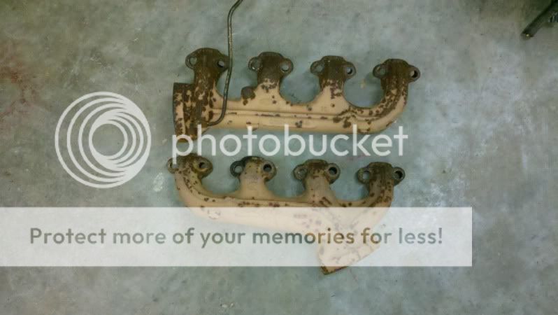

They had an old '71 F-something there with a 302 that I grabbed the exhaust manifolds off of.

Are these the manifolds that will work? Does anyone have a pic of them installed with exhaust ran?

I used late 60s 289 mannifolds in my 86 that look almost the same for my crown vic install and they fit with room to spare. I only have one pic though but you get the idea.

Thanks for the pic bearsrngr!

I was thinking I saw a pic of the exhaust manifolds somewhere, and it was in the tech library http://www.therangerstation.com/tech_library/V8Conversions.html although the driver side manifold pictured is different than what I have.

If you want a better drivers side manifold, I have a 70's 351W (similar to the 289 Hipo part) piece that I'll part with ..................cheap.
By "better" do you mean it will flow better or fit better?
