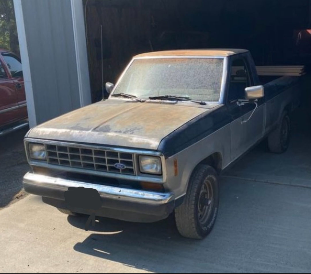

Here’s the picture from the Marketplace ad. This is the probably the best overall picture of it there is, but there should be more as we go along.

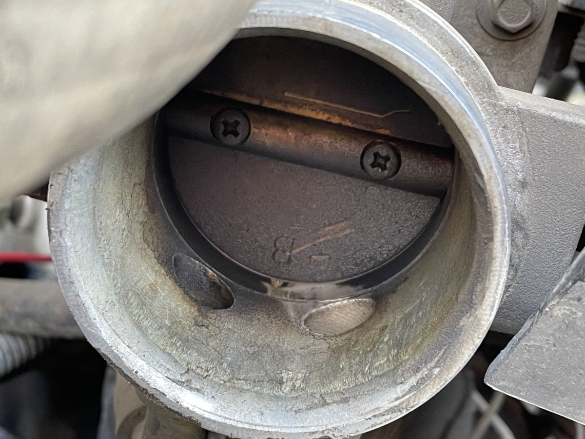

One of the first things we did was the tune-up. I’d say it hadn’t had one for a bit before 2006, as the SplitFires were pretty damn fouled.
We also did a SeaFoam treatment as part of it, gas tank first and then the throttle body. The SeaFoam in the tank REALLY helped to smoothen the engine out; throttle body freed up the butterfly plate and complemented the tank treatment:

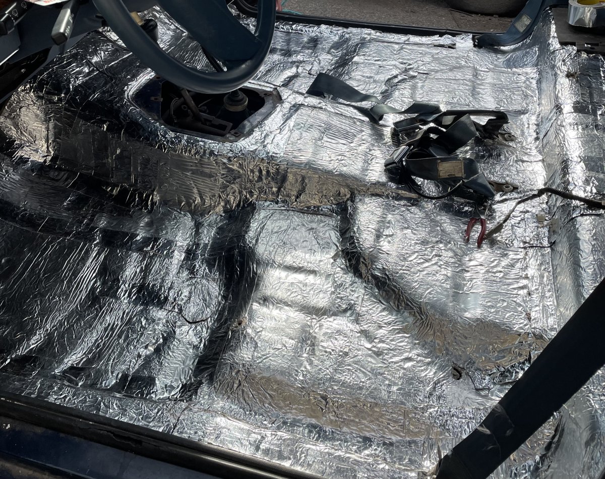

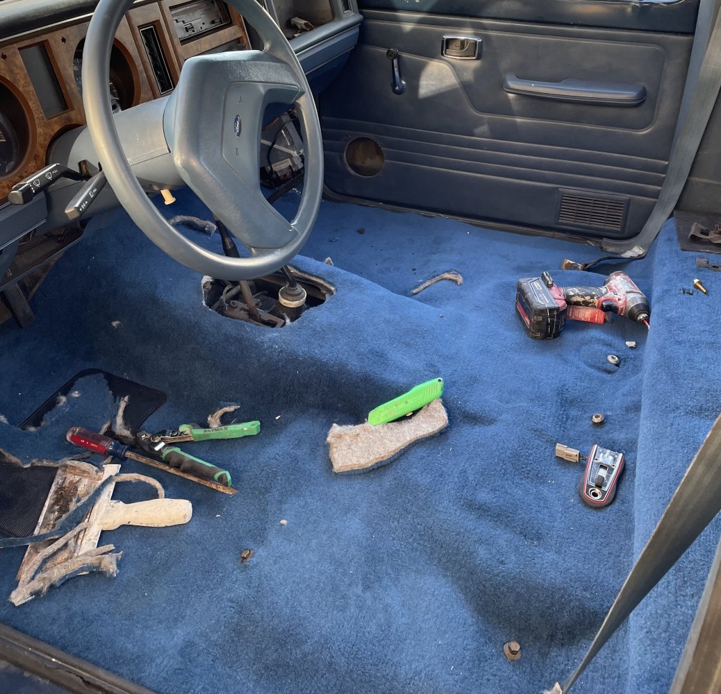

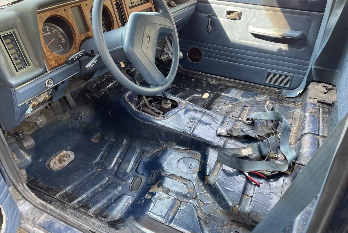

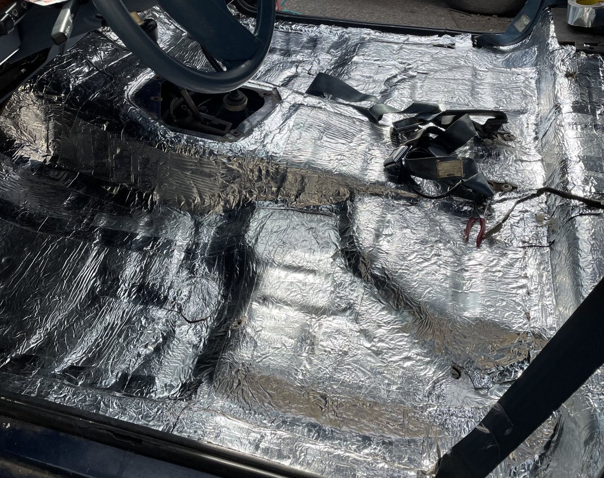

Next up was the interior. The PO had taken out the original carpet as it was apparently a mess. He had bought some new carpet and had yet to install it. We took the seat and belts out, then degreased it with Purple Power. After that, we laid and rolled some Frost King duct insulation down to help in heat control (this was the fall of 2021, still pretty warm here. Made a decent difference when I opened the door the next day).
While we were doing this, I had let the new carpet lay out in the sun for a few days. I had heard horror stories about ACC’s product, but I was pleasantly surprised at how well it fit. The only trimming required was at the kick panels.
The product is fine for what it is. However, the PO had left the original curtain of carpet on the back wall, allowing me to see to directly compare old vs new. The ACC is nowhere near as plush as the original, and its backing makes it feel very cheap. I will eventually redo the interior and scout out junkyards for carpet or find NOS (there’s one on eBay: $350. No thanks).
There were droppings and dried urine in the vents that I removed and have written about in another thread before. During this time, the instrument cluster came out in order to ease access and replace its bulbs. Then I got thinking, why not clean it up?
I cleaned the dirt with cheap-o ArmorAll trim cleaner from Walmart, which worked perfectly. I then reglued the indicator screen with clear model glue meant to make windows. After that, I repainted the needles using Testors fluorescent orange paint that guys on an 80-86 F-Series forum had discovered is about as much of a dead-on match as you can get. I finished this up with a coat of Cerakote trim restore on the gauge faces and polished the lenses with Mother’s headlight restorer. I’ll get a good picture later, but minus the faded orange/red numbers and marks on the gauges, they turned out looking brand new.

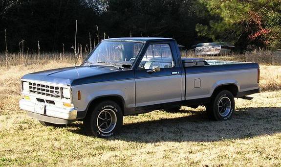

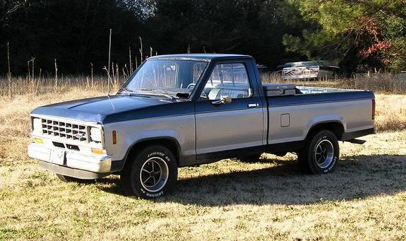

My first truck, an 84 2wd:
Wish it was still driveable, unfortunately I wrapped it around a pecan tree back in 2009.

Nice truck! Would love to see more pictures if you have any. Sorry to hear about its fate, but glad you walked away okay (or at least okay enough to type). I’m not proud to admit I almost ran my truck off the road during the first winter I had my license. Live, learn.
Me too. Unfortunately I was never good about taking pictures, and most of those I had were lost when Photobucket changed their business model years ago. Only other pictures I know I've got are of the post crash mangled mess, and I'd have to dig to find them.
Walked away, no more than a scratch and sore muscles the next day. Probably shouldn't have come out that good. I'd forgotten my cell phone that morning, so immediately afterwards I was out of the truck and trying to decide which direction to start walking. Nice old couple in a pickup gave me a ride to the gas station several miles away. Called Dad and we headed back to he truck after he picked me up. Dad was amazed I wasn't hurt worse. Just after we got back to the truck a county sheriff came around and asked if we knew who the truck belonged to. Couldn't believe that I was driving it and in the shape I was in, said he and another officer had been cruising around looking for the driver laid out in a field.

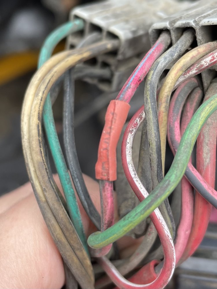

Not the most exciting update, but progress nonetheless. I got the exposed wire in the engine bay patched up today; had to cut the wrap lengthwise and superglue it back together. Works well. Apologies for the picture being out of focus.

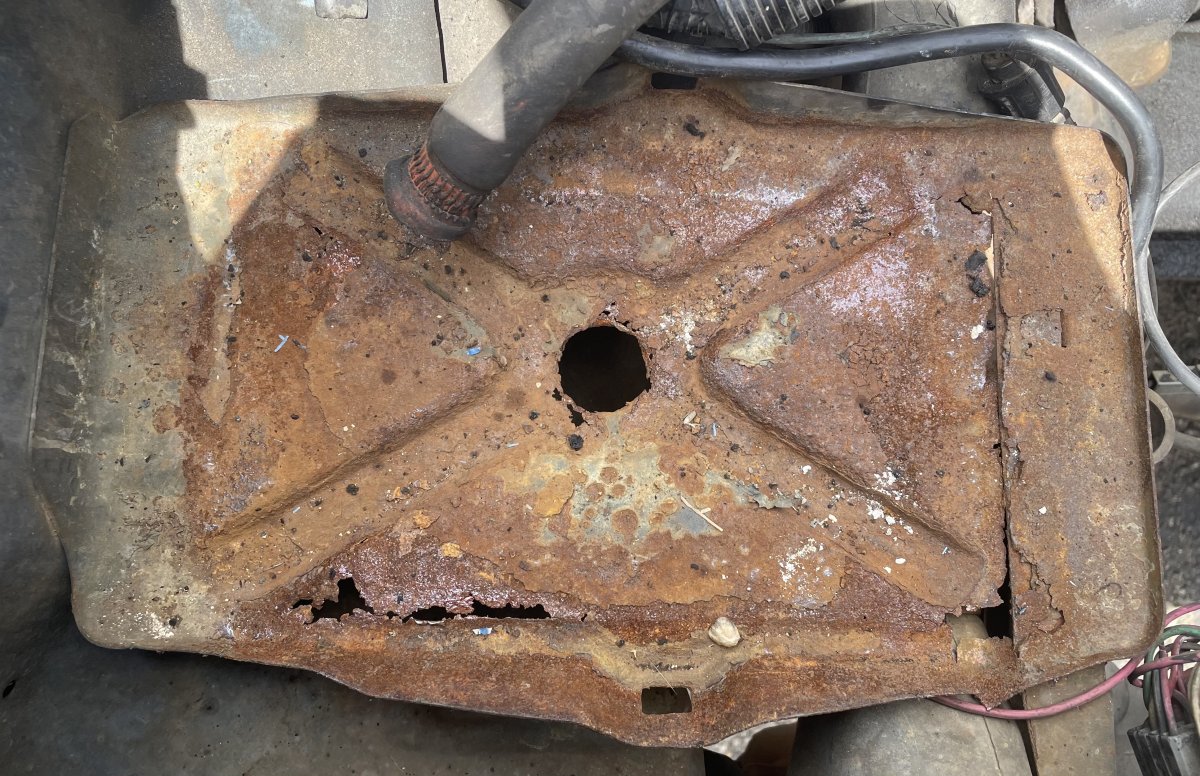

I’ve also been working on the battery tray for the past couple of days. This is what it looked like when I started. Not the best pic, but it will do:
I honestly expected none of the metal to be salvageable, but taking a wire brush to it revealed good structure. Once again, sorry for the picture.
Have Ospho working magic on it and the weatherstrip rust as you read this. Will update soon. Additionally on the interior, I installed a firewall boot in preparation for gauges under the dash to be hooked up. Was very simple: just removed the grommet in the engine bay, pushed out the precut circle in the insulation, and viola.
Definitely the easiest way to do this. I’m admittedly lazy when it comes to drilling into things and try to utilize as many factory plugs/byways as possible, though I will admit that I’m still trying to settle on the route for the lines to the gauges (right in front of the transfer case shifter). Any thoughts?
