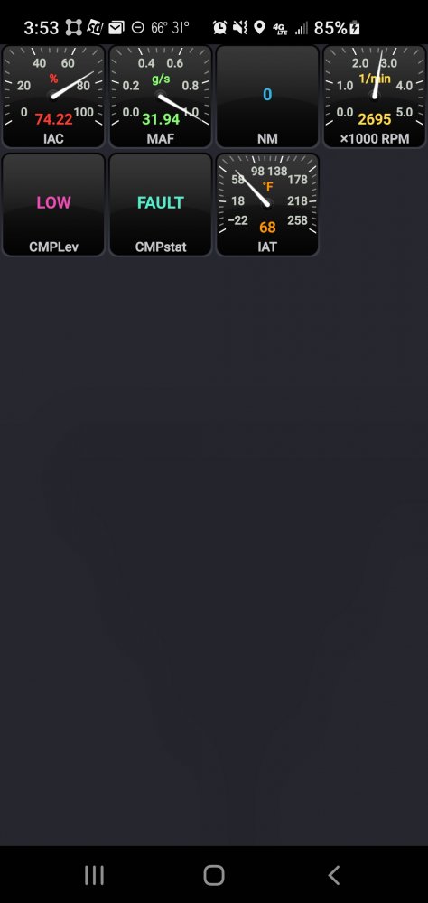

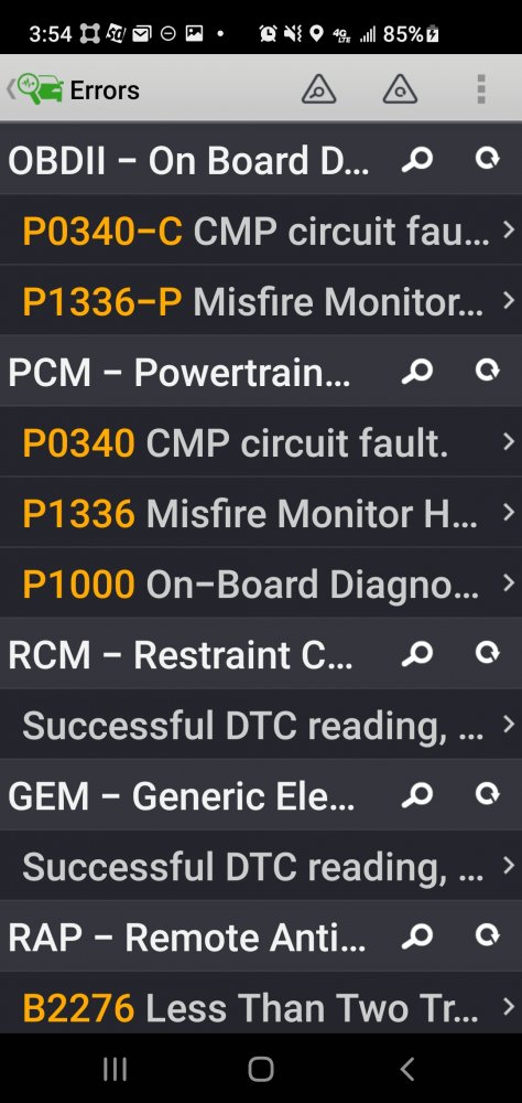

Did a drive on it today. I pulled the rockers, pushrods on bank 1 and checked everything over. Put them back in each in a different spot. Still got the ticking. Decided to take it on a drive, about 75 miles of both highway and back roads. Got almost home and got a CEL. Looked at my PIDs this is what I see

2. Completely different area, BUT I noticed my cps sensor is pointing almost straight back, I guess I didn't get the hold down screw seated all the way, now I gotta redo the timing. AS OF NOW, I'm on tdc compression, TDC timing mark on balancer is in line with tab. Question is... cause I've seen it written both ways, does the tdc mark on the balancer line up with the tab OR does the 10° mark line up with the tab???? I know I'm going to have to pull the synchronizer so I want to get it right for certain....

You will get a code of P034"x" if cam sensor is too far off of crank sensor's TDC
Crank sensor is not adjustable so cam sensor is adjusted to be withing a few degrees of crank sensor, the computer can then do the fine tuning for best injector and spark timing
If you are not getting a P034x code then cam sensor is OK where it is
Ranger Cam sensors were changed from 3 wire(1998 and earlier) to 2 wire in 1999 and up, totally different sensors so not just 1 less wire, lol

I was getting the
p0340-cand a p1336-p. I pulled it and adjusted it correctly with the balancer mark at 0. This actually helped the ticking noise I've been experiencing. Did not make it go away, but now it's at 2500k rpm and up only, were as before it was also at 2k rpm. It's not identical to engine rpm so I'm not sure wtf this is that's happening.... Axle code is 97 so it's an open 8.8 with 4.10 gears so I guess 2800 or so rpm is right. Thanks Ron.
