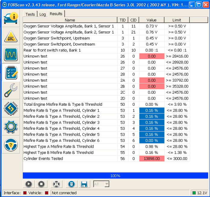

Here are my mode-6 test results:
a) Cyliner 1 to 5 have exactly the same 0.16% misfire rate, while 6 runs perfectly.
b) FORScan cannot name TID 26 to 28, 2A to 2D, but they seem irrelevant.
@mc17eln, @Shadowridr1: FYI, those Mode $06 tests that FORScan reports as "Unknown test" can be identified with those PDF files I mentioned for both of you. For example, @mc17eln, your TID $26 CID $00 test is covered on page 15. It's the "Phase 0 Initial tank vacuum and maximum/minimum limits" test (part of the EVAP testing). Those documents contain a wealth of info.
For reference, I have a recurring but very low-rate Cylinder #5 misfire on my 2004 Ranger. It shows a misfire rate of a mere 0.1635% (i.e. less than 1%, same as you) but my "limit" value is lower -- 16.9%.
@mc17eln, I wonder if your vibration might be due the idle parameters having not been fully learned by the PCM yet? Or maybe it's something else entirely? I'm confident you'll get to the bottom of it though, so it should be interesting.
BTW, for EVAP vehicle-monitor / drive-cycle testing, it's usually said that your fuel tank should be between 1/4 to 3/4 full. But, FWIW, I just checked the "Ford drive cycle" instructions and it says: "Fuel tank level should be between 1/2 and 3/4 fill with 3/4 fill being the most desirable."
Also, feel free to ignore the "failure" in the TID $56 CID $00 test ("Cylinder Events Tested"). Ford has perversely set that one up in a way that it will report a "fail" even in normal operation. My truck routinely reports a failure there once the engine has been running for a while.
@Orca Thanks for the tip about the missing test names. I also found them in the PCED manual, section 2, "Diagnostic Monitoring Test Results". They're about EVAP phase 2 and 4. Getting 0.00 for all seems to suggest my PCM simply ignored those tests.
I finally got the EVAP readiness to yes. I followed the "Drive Cycles" in PCED manual to the letter (except I didn't clear DTC in step 1), and "EVAP Evaluated" turned "Yes" in just 470 seconds from startup. However, those 0.16% at cylinder 1 to 5 are still there after a 30 minute drive, so is the small vibration at idle.

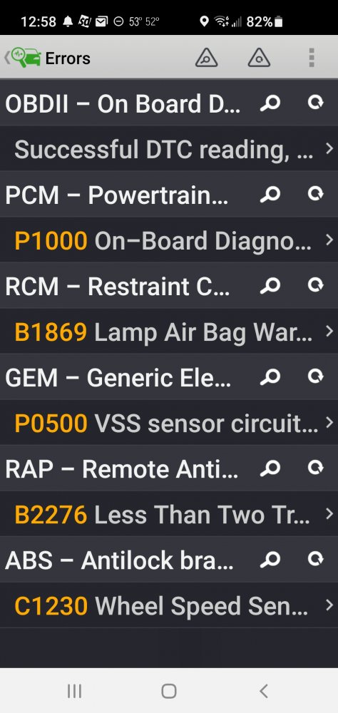

I also still have these DTC's. I'm going to change out the ABS sensor. It seems to be mentioned often when searching both the vss and wheel speed sensor issue.

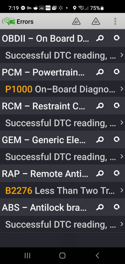

@Shadowridr1 Congrats. I suggest finishing the drive cycles to clear the P1000. It seems to have made a small difference for me. Now I have the following from mode-6 tests after a 40+ mile drive with 2 stops:

I ohmed the abs sensor and it's 1.905. My meter is auto setting so that was K-ohms. I think that is within spec. I set the forscan to ABS speed sensors the front 2 were reading the same as the dash, but the rear was reading almost 5mph slower than the other 2. I put a test light on the 41 fuse and it's good. I pulled it and ohm tested it as well. Same results....I replaced the OSS sensor and still had the ABS code. So I went back in got the ABS sensor and all good
