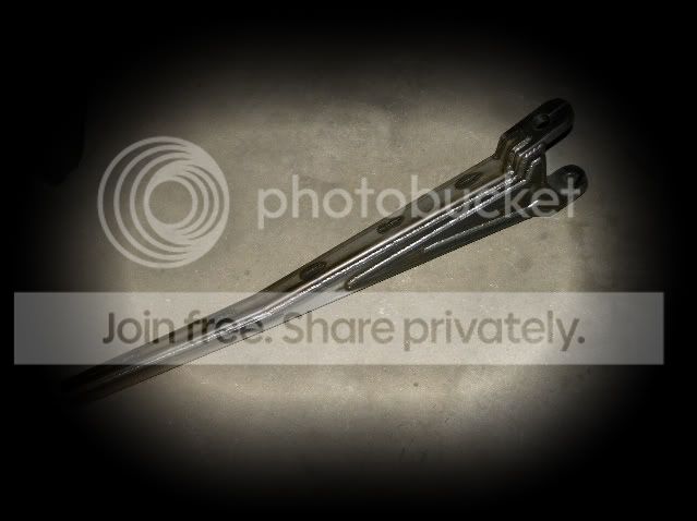

If you havent checked it out yet..
New Equal length "ghetto" King pin kit..Its those most affordable one out there of its calibar.:D
New Equal length beams with billet D-44 ends.
