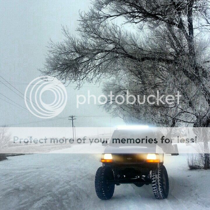

Drove a 600 mile round trip to Kansas with no major issues with V8 or solid axle. Truck runs good also got my led bar mounted and wired up
Even got a blue switch!
Only thing I need to do is make new mounts for my bumper and fix a few small things

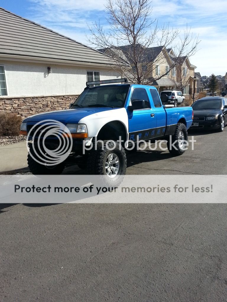

Haven't been on here in awhile so I figure its time for an update. So the truck runs good but once again I'm having problems with my 4x4. Sounds like something is grinding in the front axle but I think the u joints are binding. It was working fine before I put in the explorer leafs but they lifted the rear 2". I put in 4° shims under the leafs and it helped with some vibrations but it didn't fix it. Anyway heres some recent pics
Also gunna swap to an 01 front end with new taillights. Only thing I need is a grille.

Thanks man. Axle was from the junkyard its out of an XJ. That's my friends AR-15 with a bunch of stuff done to it that gun was awesome. And the red truck is a co-workers
Did you beef it up at all or is it just stock. what gears are you running. Do you think the 35s are to big or is holding up good. any problems yet. did you narrow it at all
Trussed D30 with 4.88s everything holding up fine with 35s
