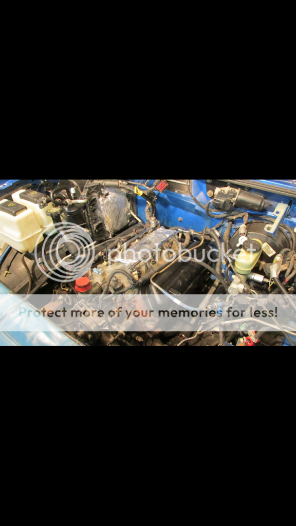

Engine bay all cleaned up and ready for 5.0

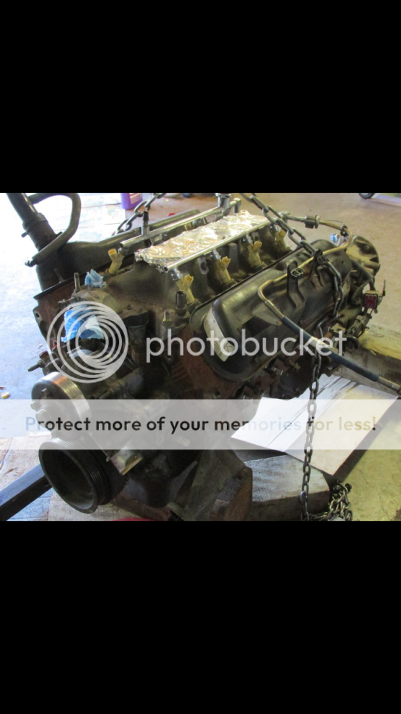

5.0 all taken apart

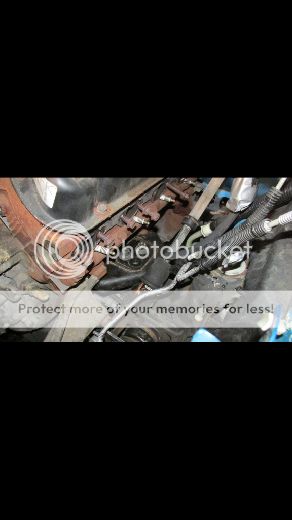

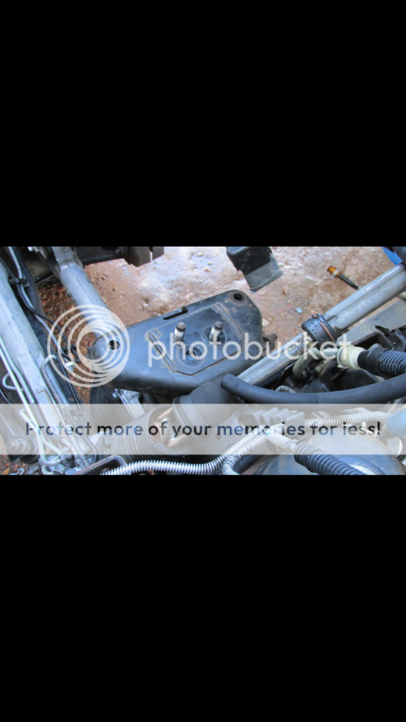

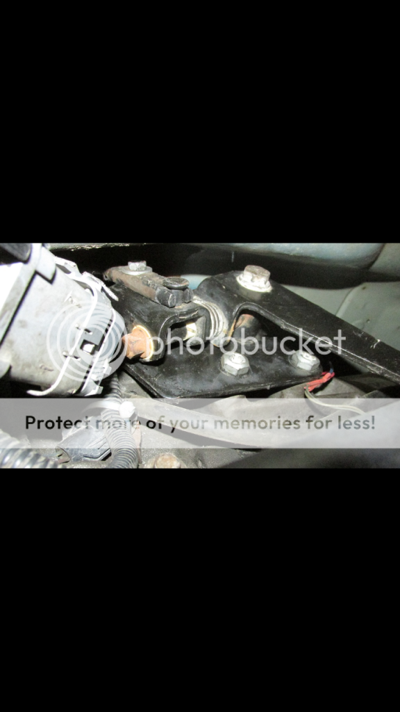

Had to drill a hole in the motor mount 3/8" inch to the right so the T-Case didn't hit the gas tank.
Motor bolted in
Radiator is tight!

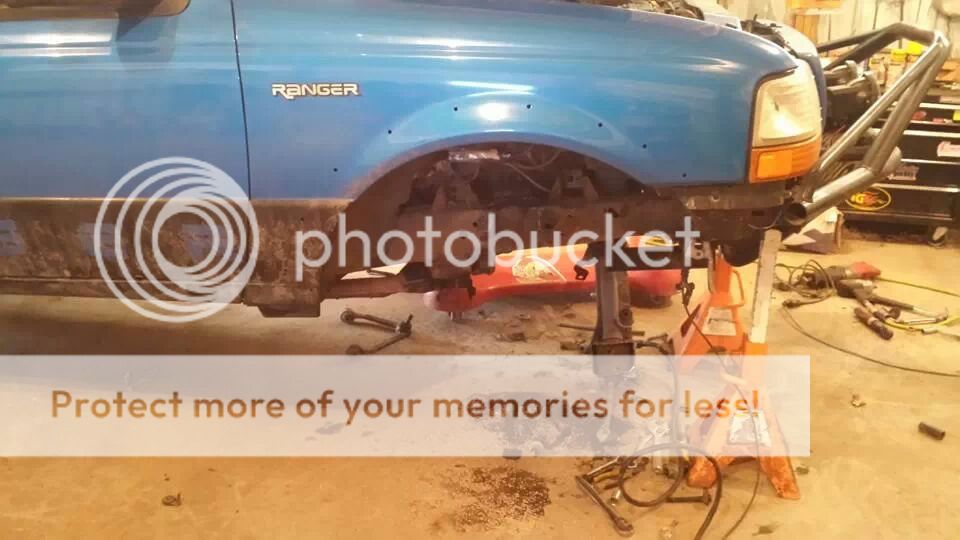

Got the steering box moved, Long arms built
Steering built
Under the truck

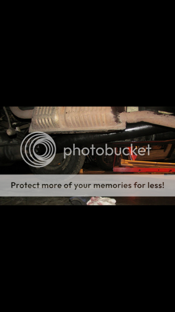

Still needs front Driveshaft but the transmission crossmember is in the way... gunna have to cut into it a lot or make a different one. The 4406 sits so far back I need a 36" front drive shaft...

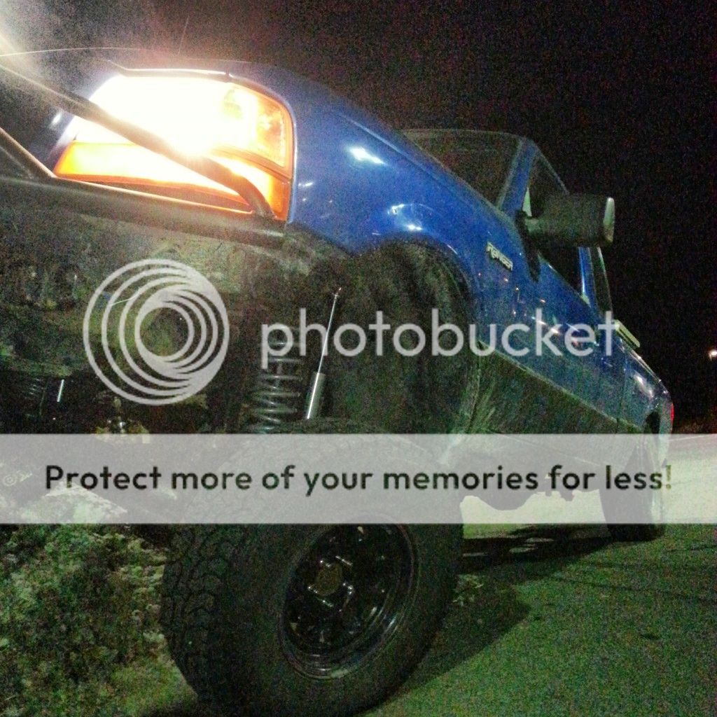

I wish I could do all that but 3 kids takes a lot of money and being a farm hand takes my time good job your truck is sweet I like the sas and 5.0 but I'm not into pre runners. All I see is corn fields and mud
ps what did you do with the coil over shocks
