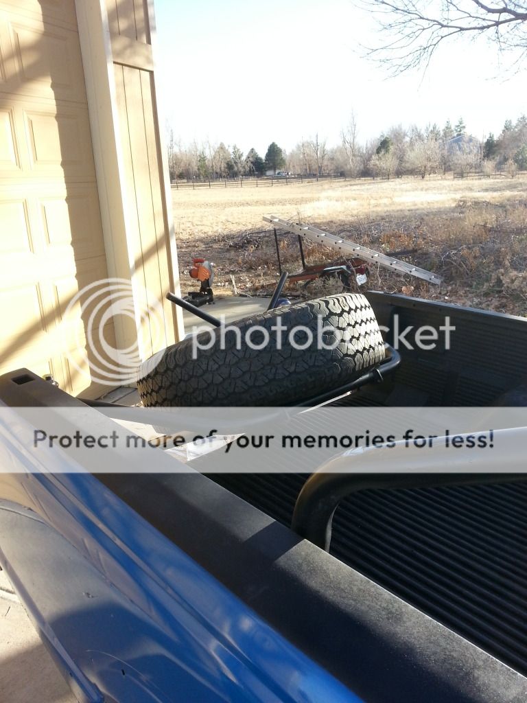

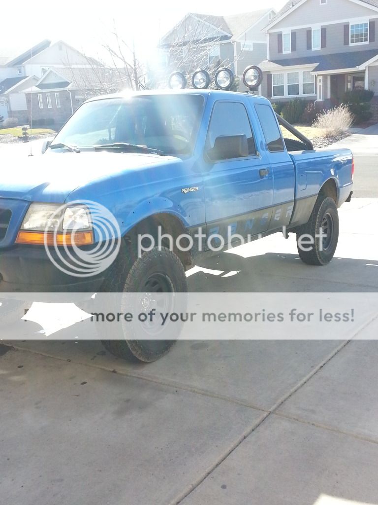

Then I took off my tire mount on the roll bar and modded the tire carrier underneath to carry a 31"
All I did was cut the little support thing off
And it looked like this for awhile

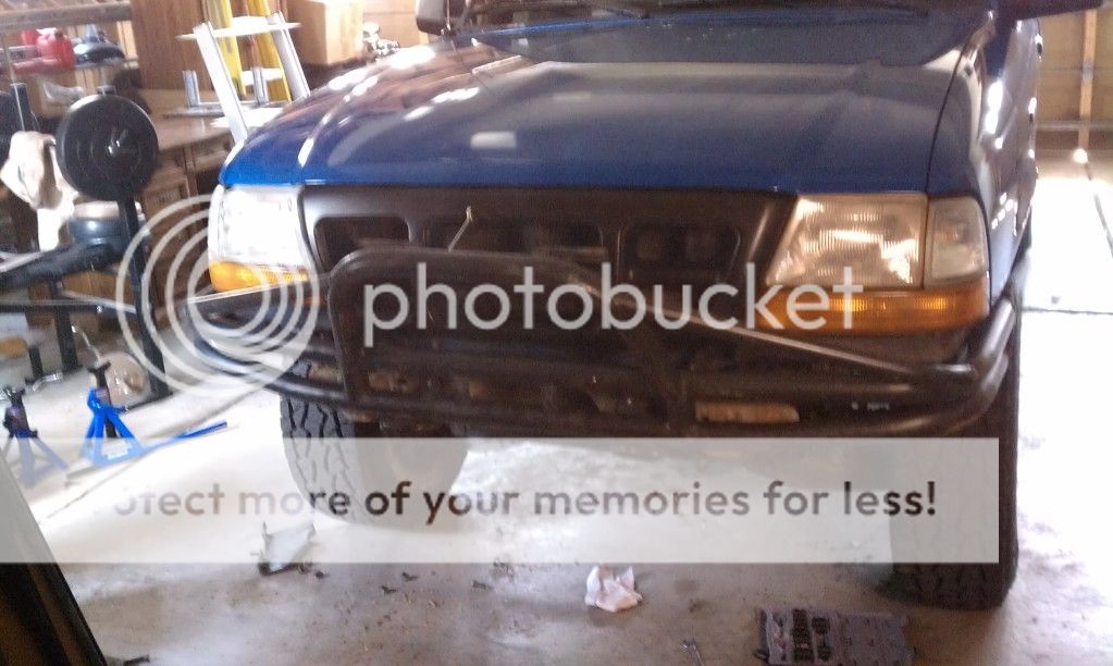

Then I bought a bumper but haven't made mounts for it yet because I don't know if I like it or not. I want more of a prerunner bumper. What do you guys think?
Mocked up

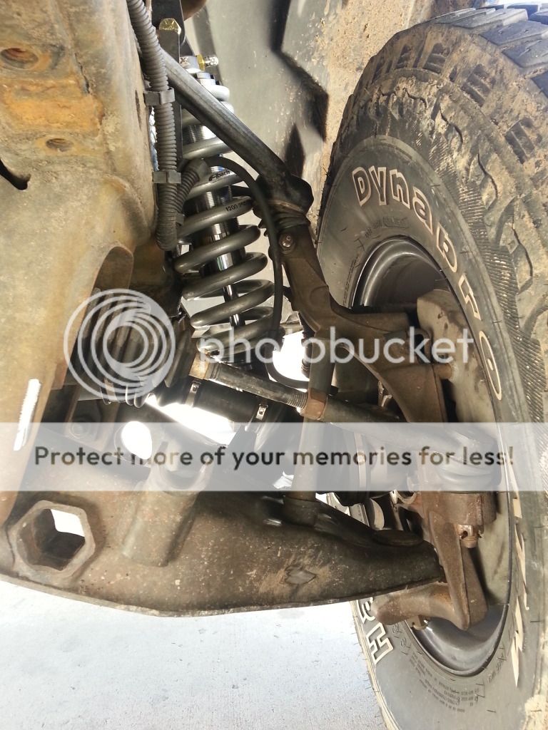

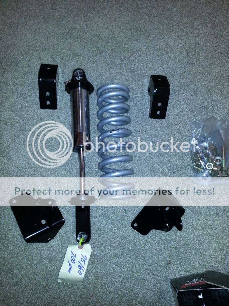

And my most recent upgrade is coilovers. I have the brackets and everything I just need to mount them (which may take awhile because I don't have the tools to do so). They are Fox 2.0x5" emulsion shocks and 12" Eibach springs
Oh and when I install the coilovers I'm going to convert to live axle. And I also ripped out the explorer center console because is squeaked like a mofo and I was getting sick of it.
Ok got everything in and for anyone wanting to do this conversion and 750lb springs I wouldn't recommend it. I just got everything installed and it is incredibly stiff... I may even say worse than cranked t bars and it almost at full droop. When the truck was jacked up and everything was installed I set it on the ground the coils only compressed maybe an inch. If you have a big steel bumper with a winch it may be a different story but the front of our trucks aren't heavy at all. It lifted my truck an additional inch or two and the coil is rubbing on the upper ball joint. That extra lift is also putting the cv axles at a horrible angle and is stressing out the wheel bearings. Its hard to tell a difference in height in the pics but you can definitely tell in person.

Look at cv and upper control arm angles
Rubbing
I just ordered some 650lb springs and should be here in a few days. On the plus side I have live axle now :D oh and I sold the bumper so I'll try to get another soon.

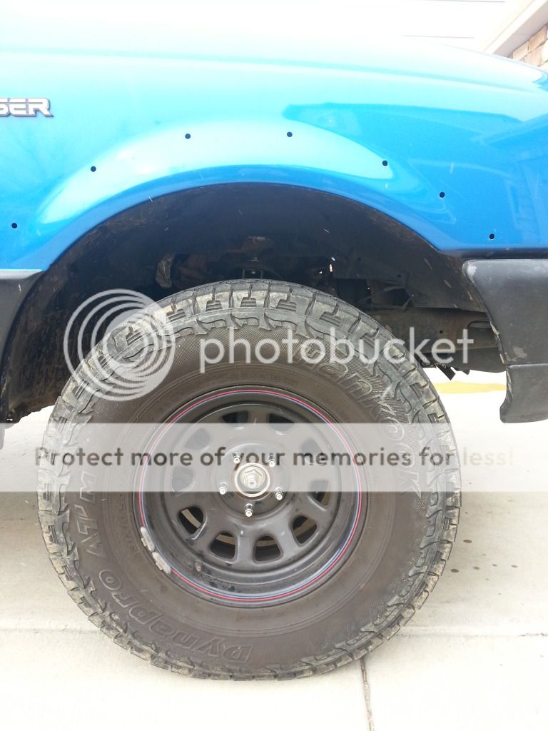

Finally I got everything done and it is much better. I kinda wish the 650's were a little softer but I am happy with them. Hopefully they soften up a bit in a few months. One thing happened while install though, the truck was jacked up and i was turning the steering wheel to get better access to bolts and stuff, and all of a sudden power steering fluid shot out of the cap (literally on to the hood) and got everywhere. (That's what's in the fender in the first pic) and now I've noticed when I turn right at like 30 mph (like on ramp on a highway) it shakes pretty bad, kinda like the jeeps death wobble if any of you are familiar with that. I just thought that was weird. I'm going to get an alignment this weekend and that may be the problem but I will have to wait and see. Anyways on with the pics
I messed up my paint job on the welds because I was in a hurry to get them on and scratched them but it's ok.
Oh and I need to adjust my coils, my truck shrunk almost to stock height haha
Before
After
Before
After

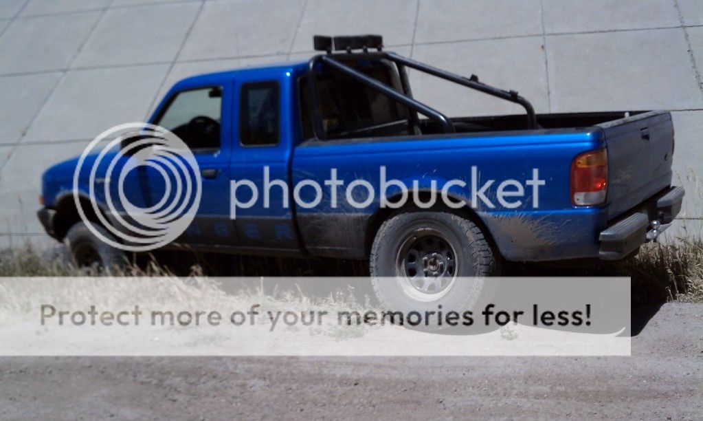

Ok well I guess its time to update this. So since the last picture the lights, roll bar, and tire gate are gone. I was going 45 when my tire gate fell off so I need to make new mounts. I took the roll bar out because it was getting in the way when loading my dirt bike. But I bought a light cage for the roof so I just need to make mounts for it and I got a new bumper.
Then I raised it and painted it

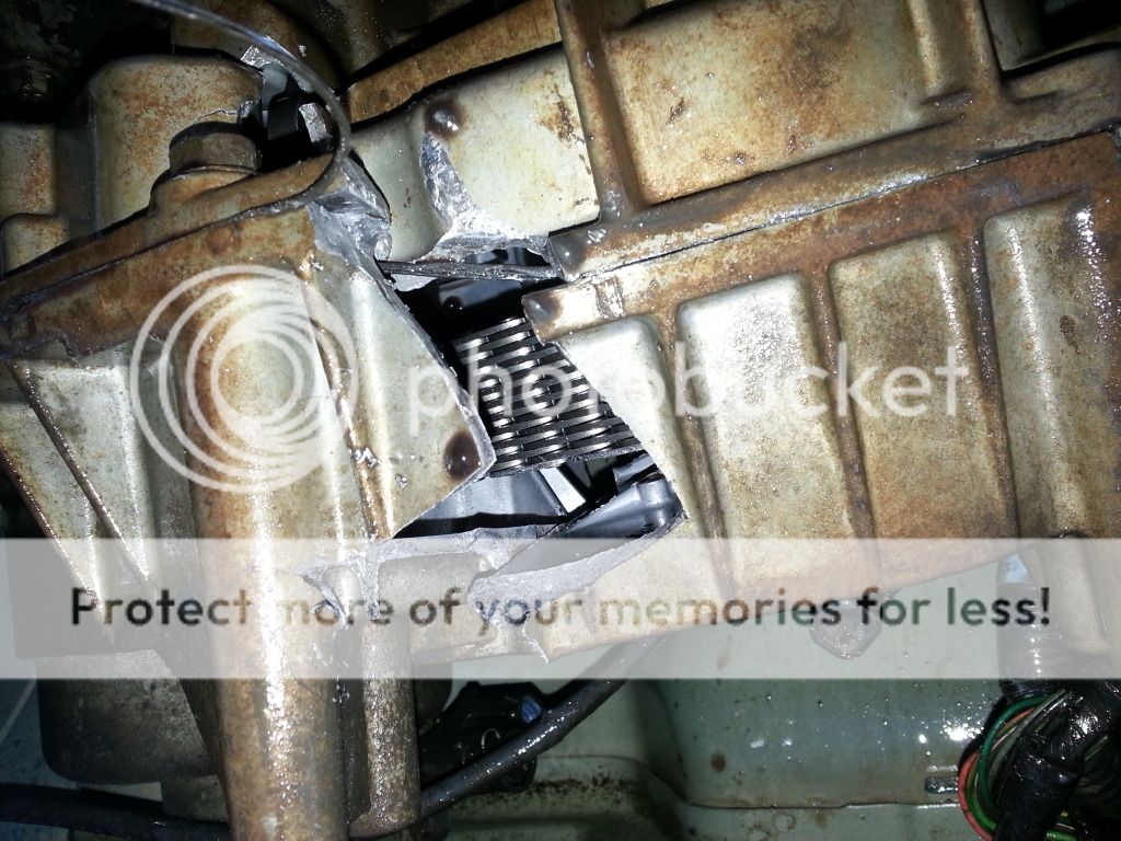

Theennnn it started going downhill from there. First I was goin 55 and the truck started vibrating real bad so I got off to go into a near by parking lot and pulling into the parking spot there was a huge clunk. I get under the truck and find my t case literally in half. This was about a month ago.
So I got another manual t case for $60 and put it in and it ran so much smoother. The next day I drove a 400 mile round trip to a ranger meet at the sand dunes and nothing broke. Thank god!

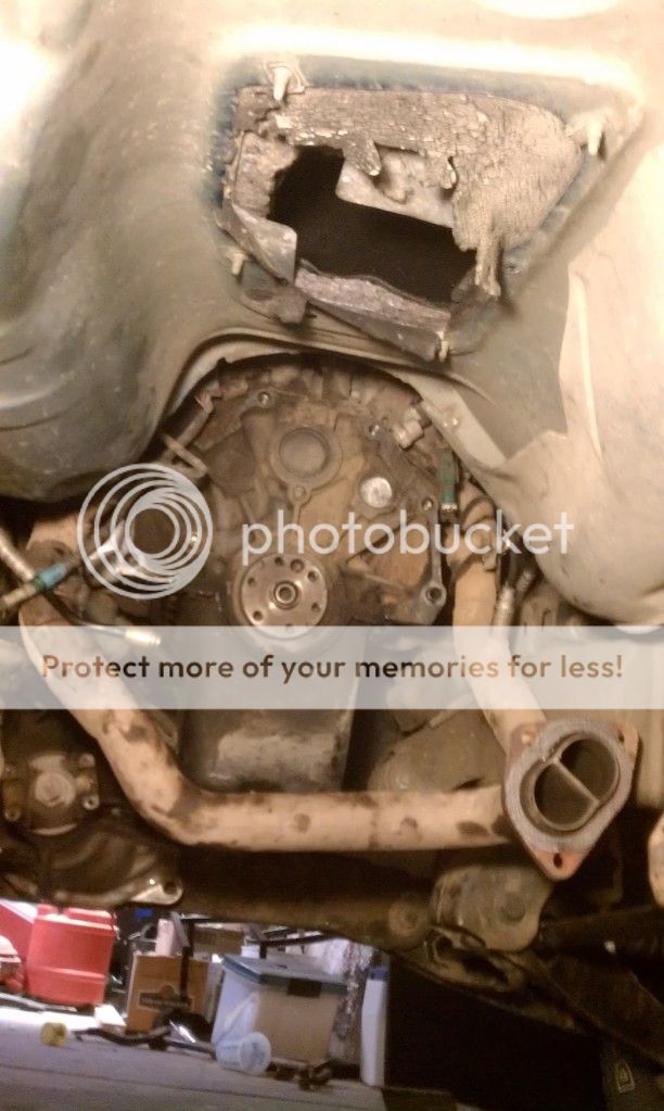

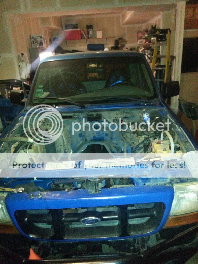

Got my motor out today!
