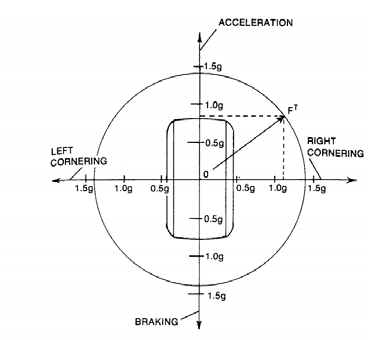

The idea is that your total available traction limit is a circle, with the friction force vector swinging around as you accelerate, decelerate or corner, and the length changing depending on how hard your pushing it. When the length of the vector grows to the diameter limit of the circle you've broken traction and are sliding. If you get on a low traction surface, you can visualize that as the circle having shrunk.
So if you are at the limit of traction while cornering, you don't want to have any acceleration or deceleration forces reducing what's available. In the picture below if you need 1.4g to corner, you can't be doing 0.8g acceleration like is shown.

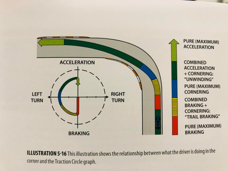

This one is a bit of a brain teaser:
Thanks 8thTon, that does simplify it enough to where even I can understand, though the example shows what I've always done, brake into a turn and accelerate out. That path should only be used on a race track though, I wouldn't want to use it on a blind corner.
