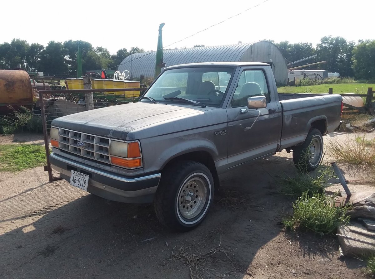

So I saw this image, thought it looked cool, and I want to do this conversion to my truck. Anyone know how hard it would be?
I know I would need to hunt down a newer ranger to rob parts from but I'll be doing a 5.0 conversion as well anyway so i'm in no rush.
Pic of my truck now for reference:
35678
The fenders on the at truck are aftermarket so easy enough to get. There is someone on site selling a pair of front fenders for $300. Then if you do some fiberglass work to the front of the fender you could match the body lines of the newer front hood and light assembly and it would look OK.
