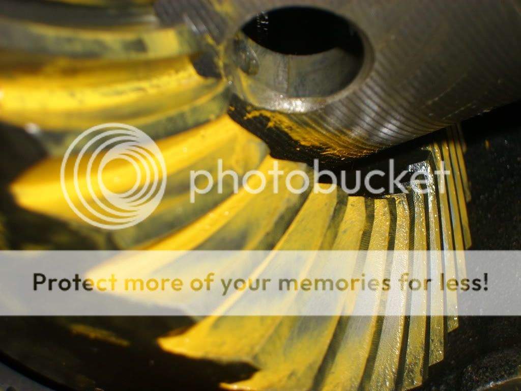

gear mesh pattern???? what now!!

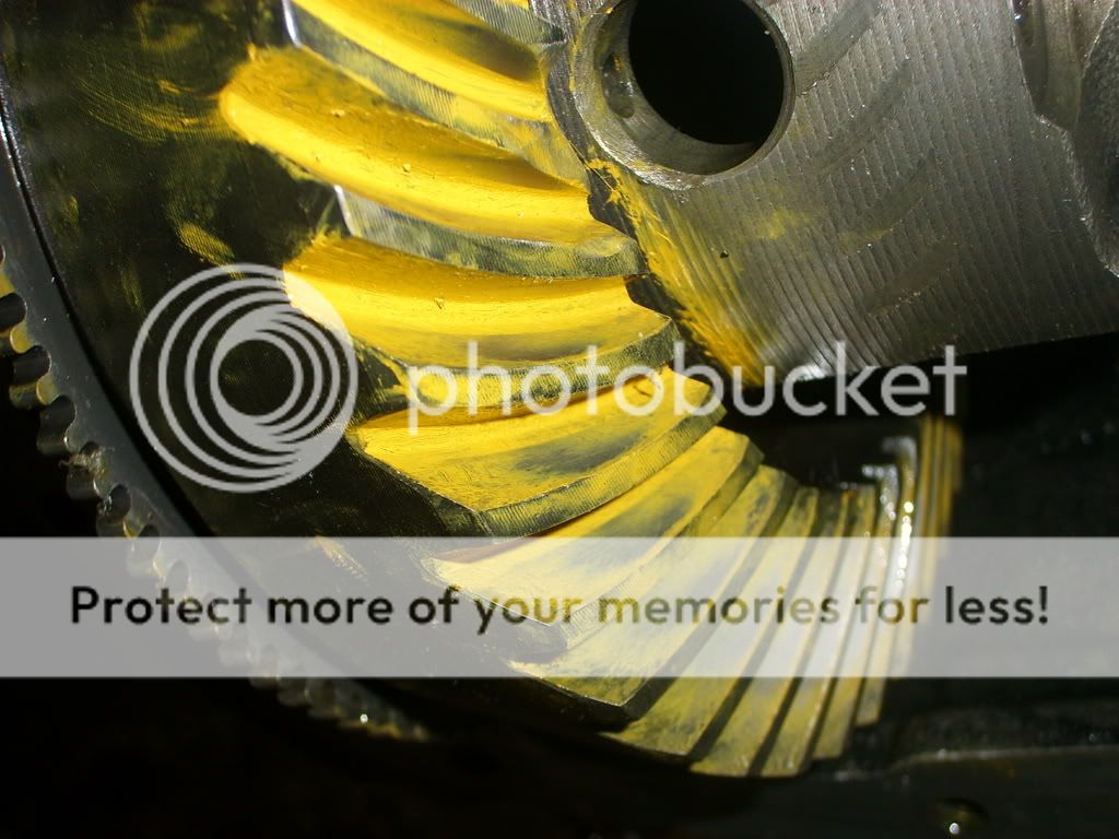

Yeah, it's definitely still much too deep. I'd try moving the pinion away a good amount, maybe .010 and see what it looks like.

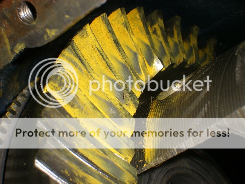

FWIW, this is what mine looked like (Yukon 5.13s):
Drive side
Coast
I don't recall the exact pinion shim amount I used, but it was within .003 or so of what was stock.

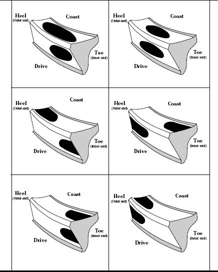

This might help out too. These are acceptable gear patterns from Yukon.

That drive side looks right on to me. The coast side is a little blurry though...
I think it's still deep. The drive pattern (convex side of the teeth) is too close to the toe, and has no "oval" shape at all to it. You're getting closer though. I'd try taking out another 0.005-0.007 from the shim stack, and try the backlash around 0.008-0.009.

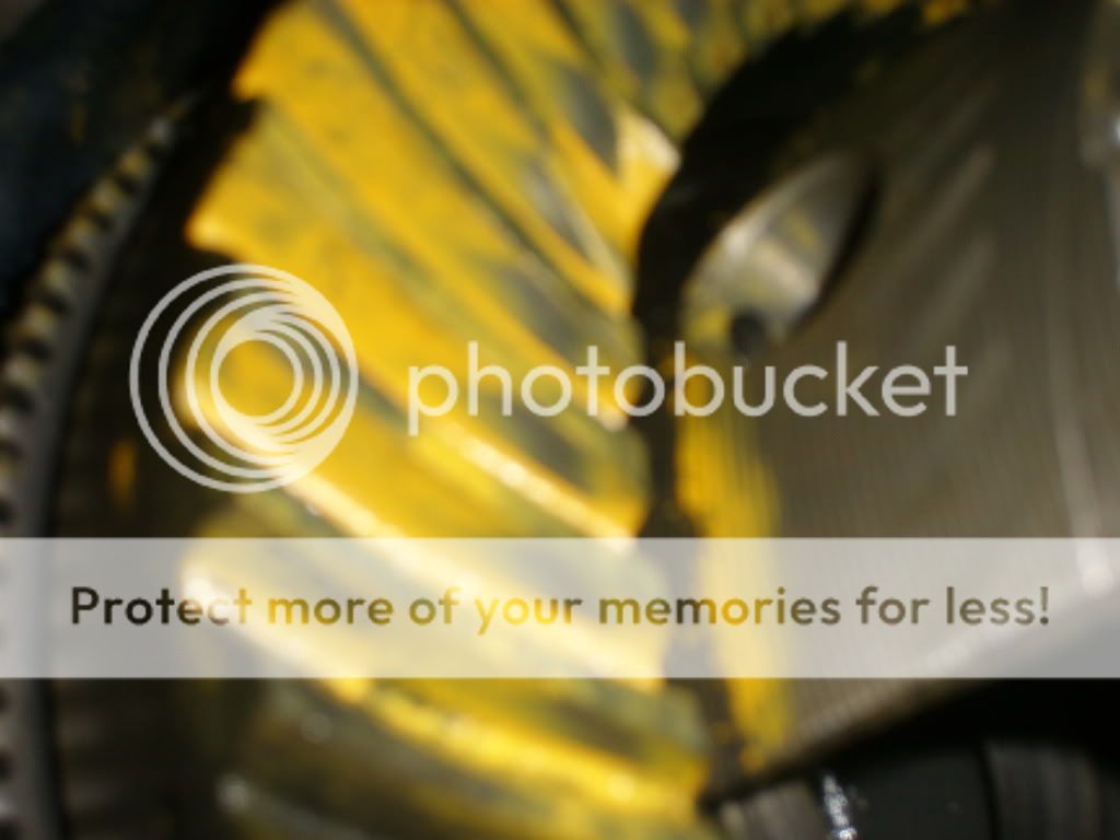

ok now i have my backlash with in spec of 14 and the specs are 11-16. so thats ok and this is what i got with a 15thousands shim on the pinion
Backlash is a bit much but still within spec, i'd run it.
Spec is .008-.015 (straight outta the Ford book)

Your coast side pattern looks good, but that drive side pattern I think still needs work.
Most of the Yukon gears I've set up have always had decent patterns, I'm thinking try taking yet another .005 off the shim stack and tighten up the BL some and see if it improves or gets worse. If it becomes worse, then I'd say run it like you have it above. I think you'll have some noise on it though.
