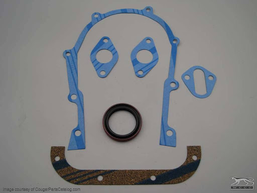

Just sillycone the bastard. I've always seen those partial gasket peices though...
Not a 3.0 but just showing what I mean...
Ye
Yeah I knew what you were talking about. I have seen them before now that I see this picture. Unfortunately they don’t make the kit that comes with that. Like I said everything I saw from YouTube videos people never touched it.

So the way it works is that the oil pan sticks out a bit from the main block. That bit that sticks out mates up with the timing cover and provides some sealing along the bottom for it. In fact, you have to rtv the corners where the two meet. If you have the old style oil pan gasket, I could see where you just put a fresh gasket part in, rtv/silicone in position and be done with it. In my case I am a masochist so I dropped the pan and replaced the oil pan gasket with the new, upgraded gasket. You can drop the pan without removing the engine block and replace the gasket but it is a giant PITA. dropping the pan involves loosing the motor mounts, removing the starter, removing the accessories chunks, cooling fan, etc, etc. Up to you how you want to go about fixing it.
