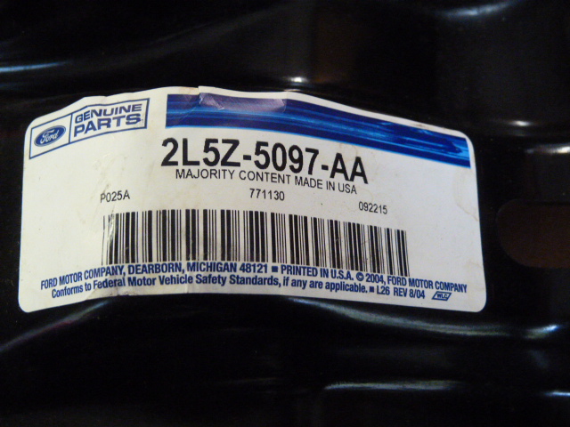

An ancient thread, but in case it helps, here's a couple photos with SN on the "gusset" as some injunear calls it.
I still call it tank strap hanger bracket.
Well, at least you found one...I didn't realize it was a small piece that could be replaced...
Do you need to remove the cross member to install that or can you weld it in without the extra work?

Not sure if you have to remove the crossmember or not. I do know that the bracket is riveted to the frame, and I'm assuming to the crossmember.
The new bracket is thru bolted to the frame, and comes with captive nuts.
This thing ran me $70USD.
