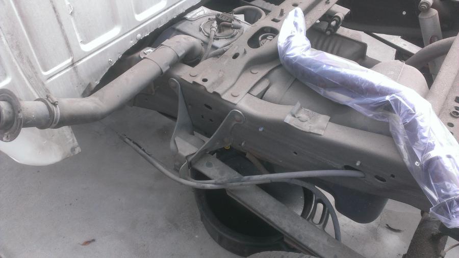

Does this work for ya?
Thanks Rev!
If my old eyes do not deceive me, it looks like all the pickup connections are flexible, so I can drop the front of the tank down far enough to get to the band clamp on the filler hose. :yahoo:

Thanks Rev!

I'm sorry I didn't get more pics of it with the bed off. It didn't really occur to me. If you click on the pick, it goes a lil bigger and you can do some zooming on it before it goes all pixatosis.
