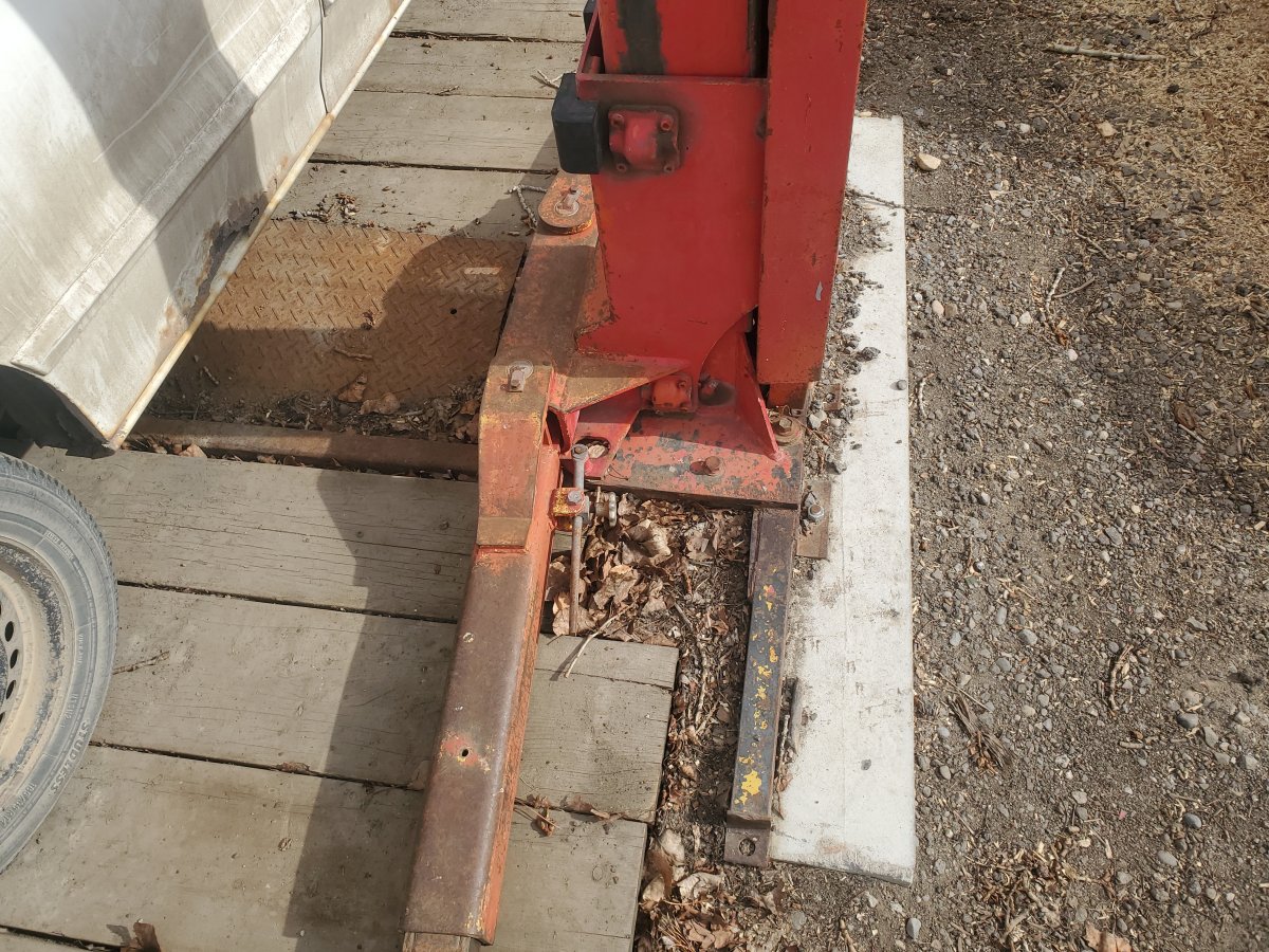

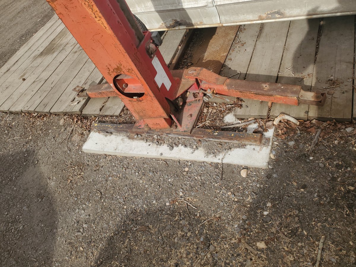

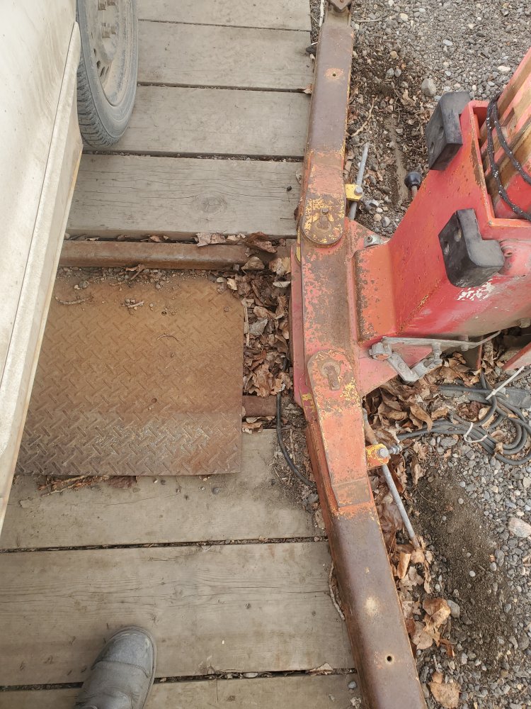

My boss has a 2 post outside. Looks like he poured 2 footers about 1.5' wide by 4' long by ?' deep. He then used 2"x2" square tube to laid over top in an H bolted down over the concrete. Then welded the 2 post to that. I've seen a newer F150 up on it. Apparently he built it about 12 years ago. This is on ground asphalt road that was laid in 6" courses and vibratory tapped into place each course. I believe he built it same as a roadway, so pit run first, then asphalt. So I would say that a 1" or 1.5" would be fine, as long as the original ground prep was done properly. I'll post pics when I find them.
