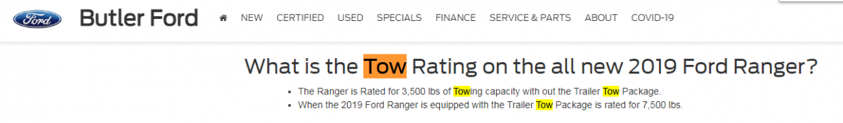

Pulling a 5k trailer in Colorado with some numbers/math:
I picked this up off a dealer web site, note that it is for 2019, could be different for 2020 or 2021, check to be sure. So.... yeah towing package for sure!!!!! Hope I didn't cause any confusion.
Going up mountains, or even a strong headwind, you may well be in the boost 100% of the time. Will leave it to the mechanics that work on them, as to whether the engine transmission are really up for that sort of duty cycle.

I'm 99% sure theyre the same regarding year.
