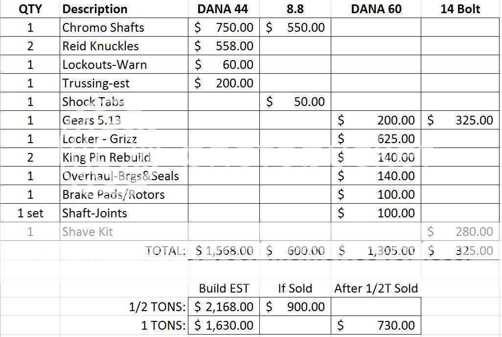

Well, looked up some pricing. Building 1/2 tons to handle 37s and a V8 is a lot more than I thought it would be. I will probably end up parking out my 1/2 tons.
I currently have one of each axle listed. I just spent $500 on a Ford D60, but I can get that back by selling the Chevy 60 I have. Therefore, I did not work in 'initial axle cost' numbers.
Rough numbers I came up with:

I love when you make spreadsheets :icon_cheers:
That's really not too bad price wise.
:icon_thumby:
Not at all.
