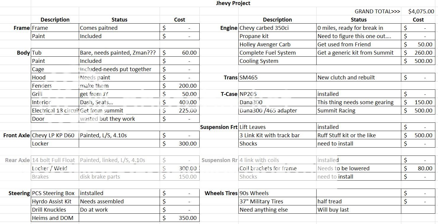

I made an excel sheet that ROUGHLY states what it needs. I estimated the costs too. We are looking at ~$4k to finish it excluding new wheels and tires. That kind of money for a fully linked V8 rig isnt bad IMO.
Plans:
Lower it... A LOT
3 link front would be nice. But will rock the front leaves for now
Different tires
Turn the 2 seater cage into a 4 seater cage.
Shave the 14 bolt at work.
Lower it... did i mention that?
Better crawl ratio. It is currently 52:1. Not slow enough. I am thinking a Dana300 swap. That will get me to 70:1. Or maybe just do a 203/205 doubler but those are HEAVY! A doubler will get me a 105:1 with 4.10s. I do want to drive this on the street.

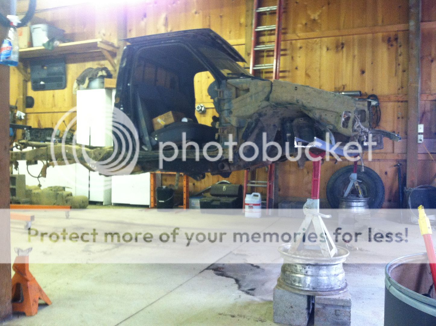

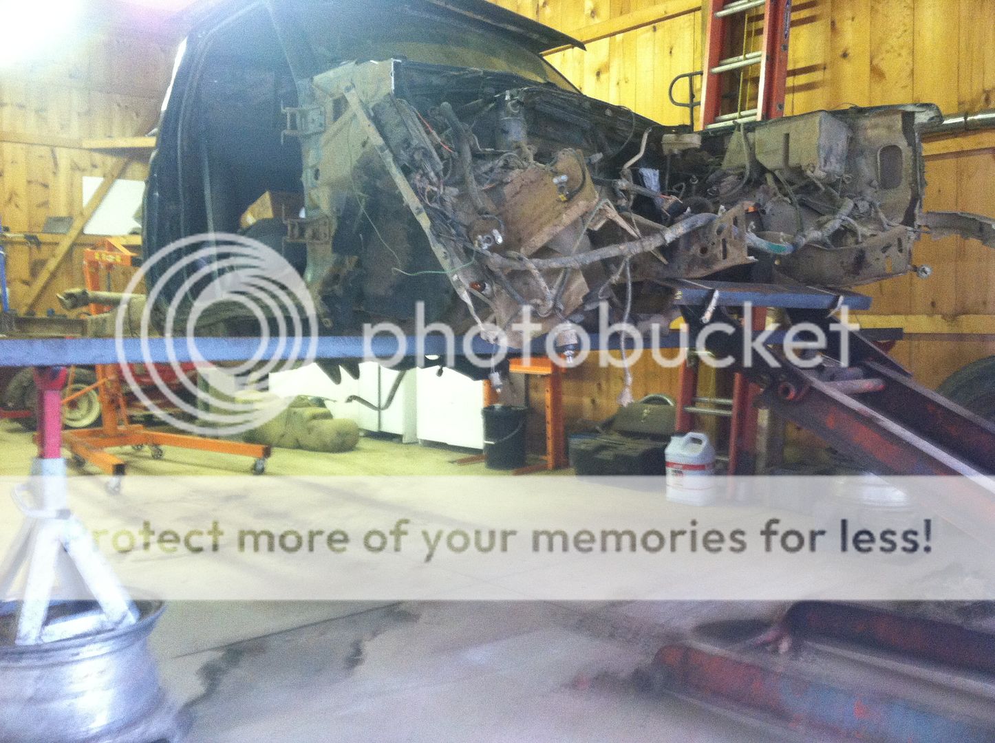

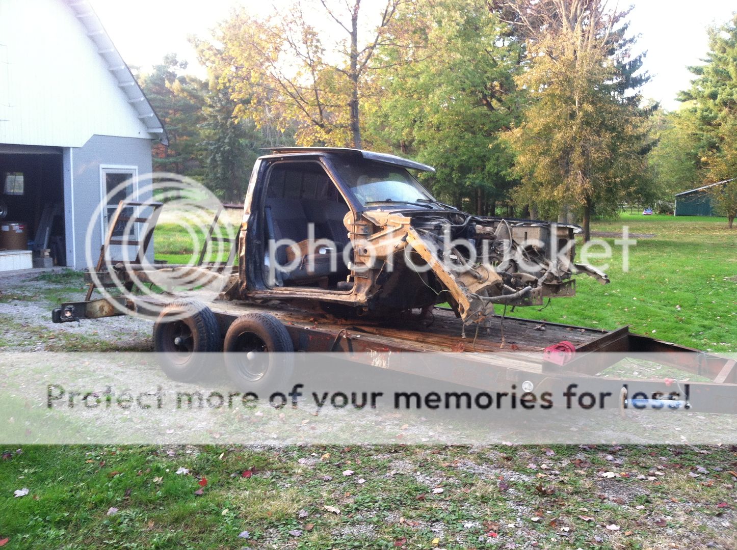

Well, This Saturday will be the day she is put to rest. She will become melted and hopefully become the steel of a new Ford truck. One can dream right?
Yes, I know I need to buy a 2 post lift. But I get by with what I got.
Floating Ranger

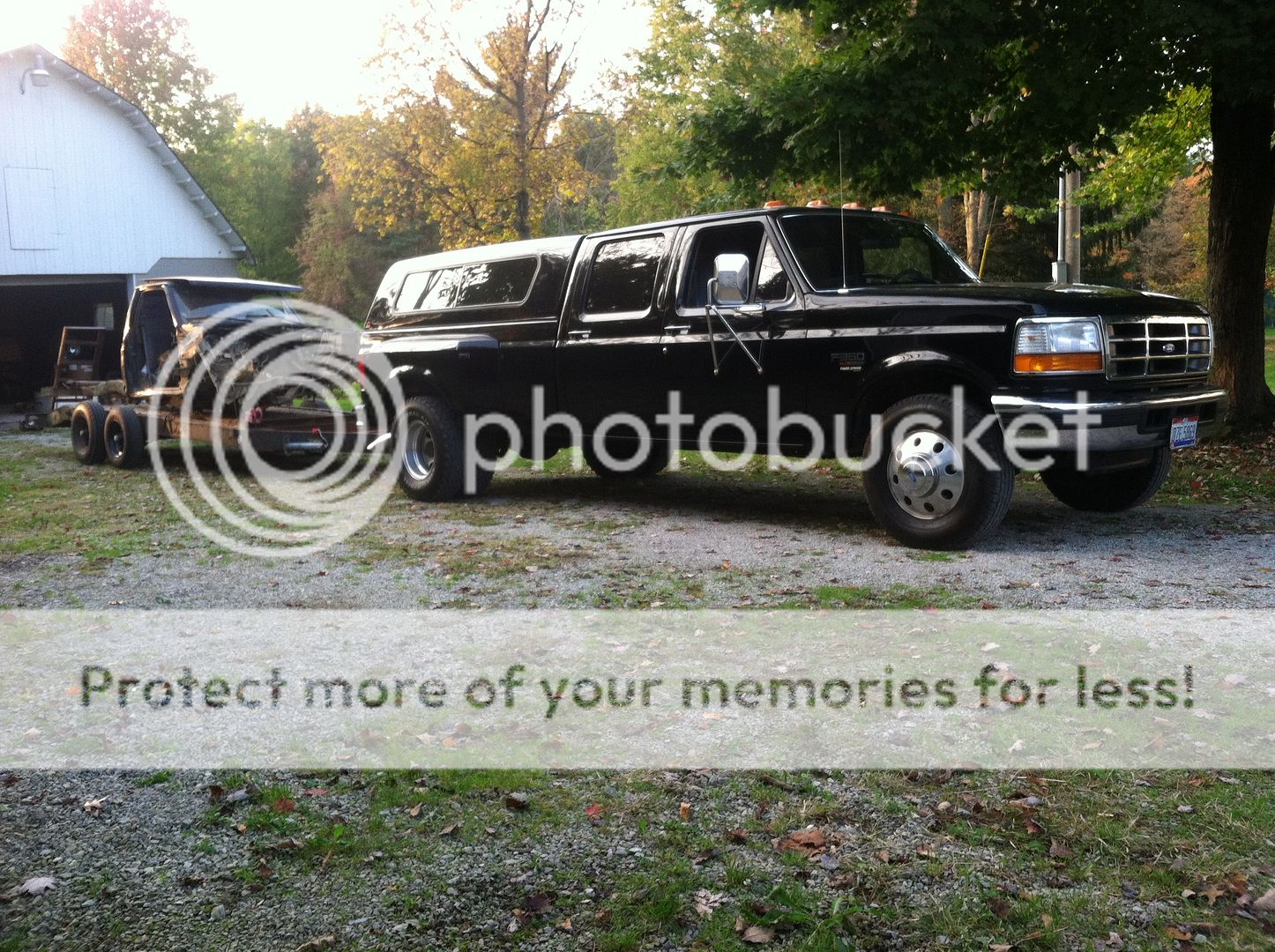

And successfully got it on a trailer by my self.
