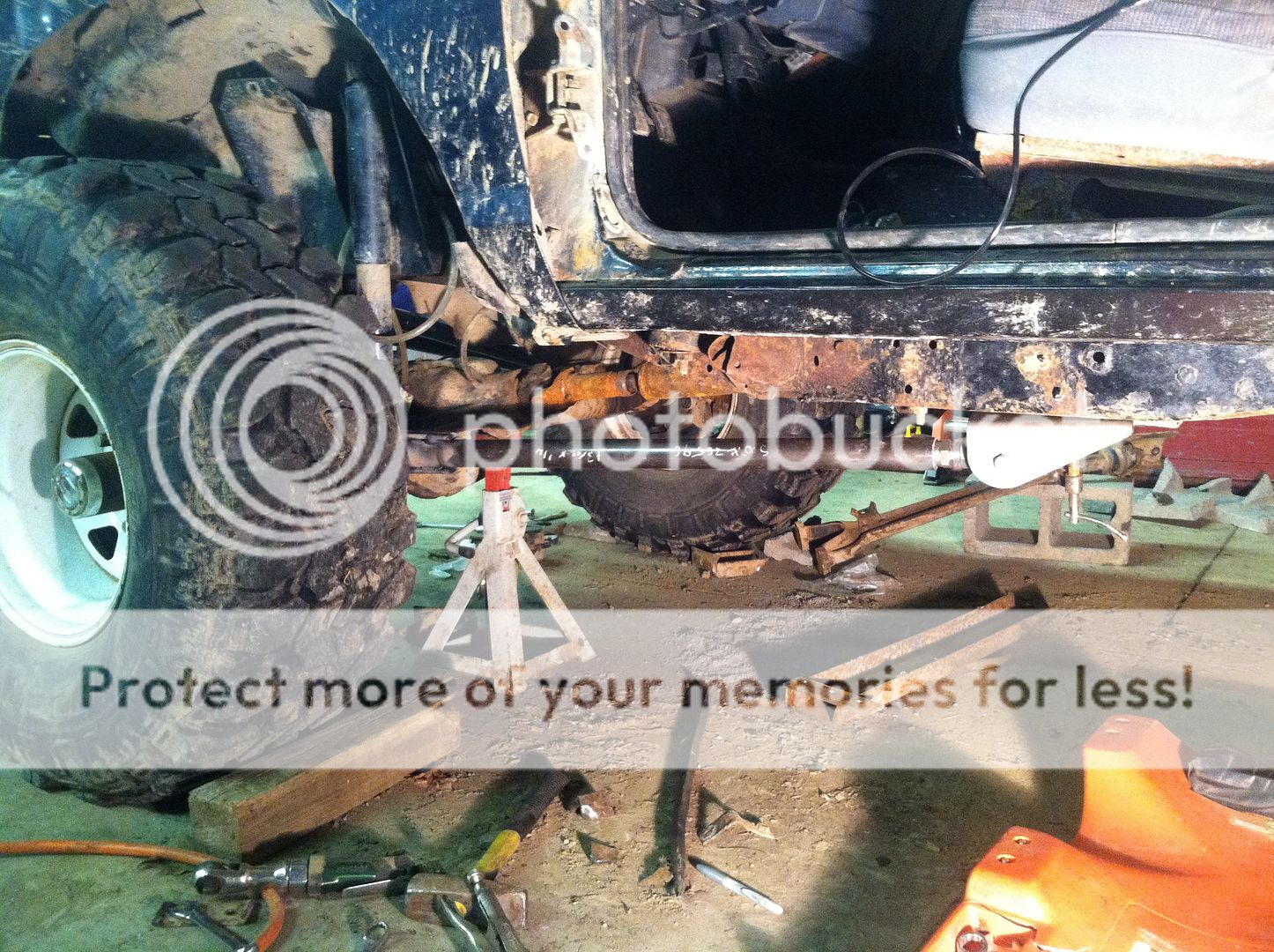

Progress. Drivers arm is fitted. Passenger arm... well i started it but realized the trans cross member is in the way. So i will need to make a new one of those.

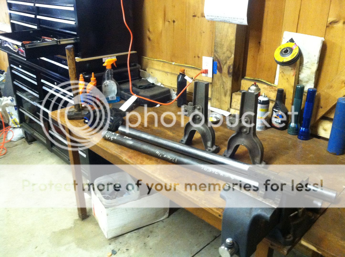

I have to finish welding my arms. I also bought some 1/8" plate. I am going to need to box my frame where the arms mount.
I also had to ditch the trans cross member. So I will have to figure something out there.

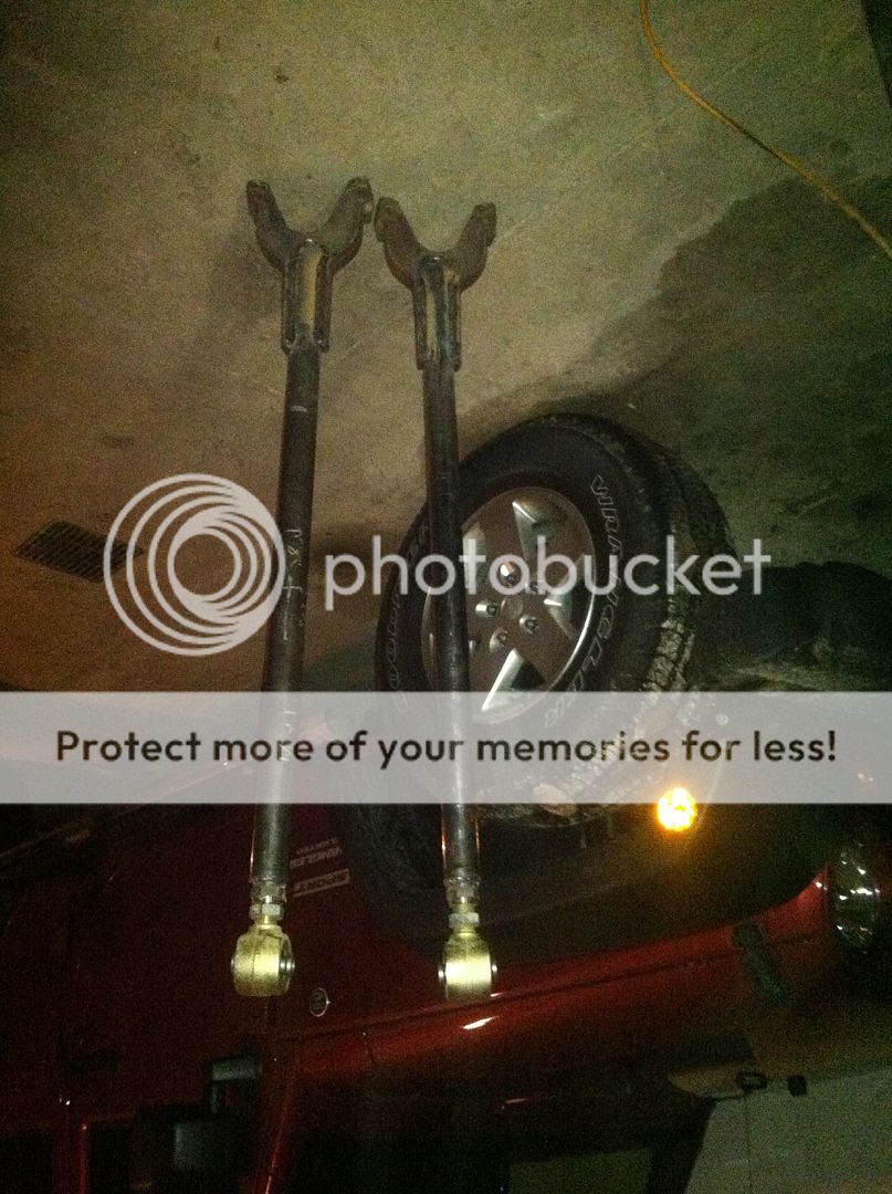

Arms have been fully welded. Just need final fitting and paint!

How long are they from center of the mounting hole to the inner most part of the "C"?
They are 43" from the flat to the joint hole. So about 40" from the inner part of the "C". I might have made these too long haha
