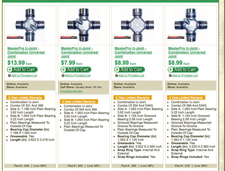

I'm sure it's on here as I think I seen it before But for a 9 inch rear how did you bii guys hook up a rear drive shaft. I thought I seen somewhere about a explorer shaft or front BII shaft. Someone please steer me the right way doing this on the cheap. I have a 85 bii drive shaft that uses a real ujoint but looking for options
you can have an explorer sport 2dr 4x4 rear shaft shortened
or if you have the 85 shaft with a double cardigan, what you can do is take off the flange that would of mounted to the old 7.5 and install a 353 conversion u joint oriellys has them on the shelf for less then 10$
that will allow you to mix the two different joint sizes, hope that helps
Ok so it takes the joint from a 1210 ( splicer# ) to a 1310 or 1330 ? Just trying to make sense here I want my rear in by snow fall so I'm hurrying more then I should
