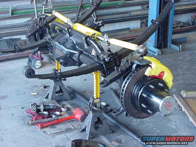

The next thing i did was put the Heim joints onto the ram and clamp the tabs on with bolts so I could figure out how to position tabs. On my setup due to the height of my steering decided to mount the body onto the diff cover. After it was mocked up It was fully welded.
Take note that you must mount the ram on the stationary body side first, after you do so pull the plugs from the ram so you can extend it to 1/2 stroke, then mock up where the tie rod side tabs will be.

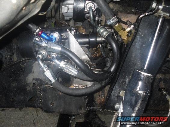

Putting the orbital is pretty straight forward, it comes with plugs in it which you remove and you put the straight fittings into. The kit did not come with instructions but you can find online the port designations for pressure, return, left, right. The valve can be mounted in any position.
Putting the lines together is also very easy. They send you a length of pressure line which is about 3ft more than enough for what i needed. Installing the fittings onto the pressure lines is also pretty straight forward. I believe a bench vice is required. You take the outer casing and thread it onto the hose until it bottoms out, you then put the casing into the vice and thread the 90* fitting into it, which flares out into the hose. Having some thread exposed is acceptable but i bottomed them out as well. The nice thing about this style fitting is that its removable and reusable. For the stock power steering pump pressure line, you just cut the hose off at the box end, and install one of the PSC fittings.
Here you can see the fittings, and I kept the stock power steering pump line. The blue anodized fitting designates return line. I have mine running into the cooler, and then the cooler goes back into the pump.
At this point You can route your lines down the ram, extend the suspension to full droop and give slightly more slack than that, I made loops in the end of my line to act as a damper so it wasn't dangling but could extend more if needed.
Once that is done its time to tie the lines up. I went to Fastenal and found some giant zip ties which were way to long but they are wide and thick, as you can see in the pictures I used those to hold the lines together.
