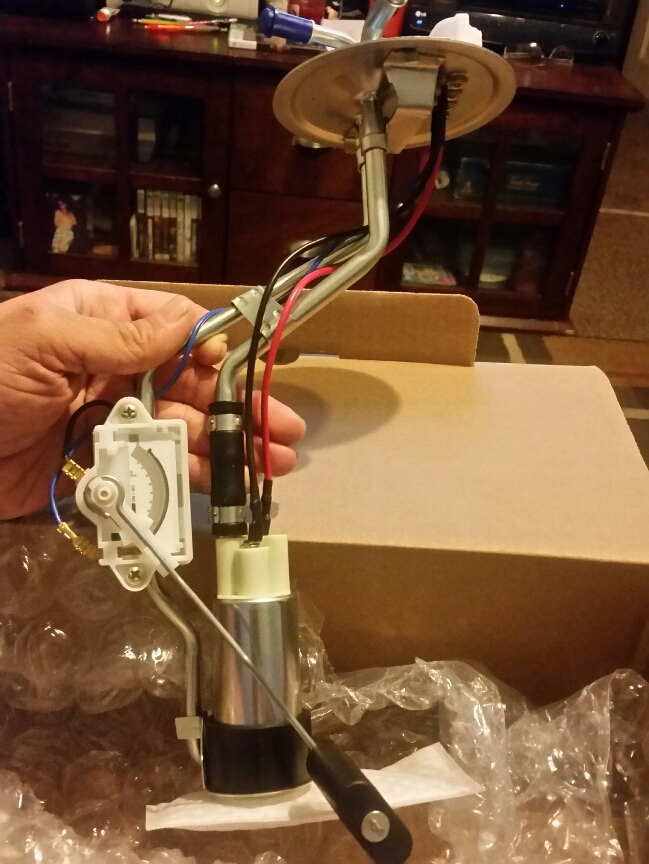

Delphi was formerly a part of the GM parts 'train', supplying them with pumps, injectors, etc. It should be decent quality, but I would take a good look to see if their assembly procedure is checked. Some have found the short section of fuel line between the pump itself and the sender 'body & tubing' is installed properly. I have read / seen pics of where the assembler was on vacation or lazy, and the line was kinked or not installed onto the pump & tube. Take a look.
When I take the old one apart, I use what are called 'waterpump pliers', actually slip-joint pliers with about 5 different settings of the jaw 'width'. Use them on the tabs that stick up on the metal ring, squeezing to force the ring to un-screw. You do not need a hammer for most. Install is the reverse, just squeeze using the pliers. No sparks...

Looks like it was assembled with good quality as you can see both ends of the tube well within the rubber part and clamps. Unfortunately I did not get a chance to put it in this weekend, I am trying to give more time for the residual water to evaporate before removing the plastic from around the connection and lines. Since my daughter doesn't have karate tomorrow I will probably so it after work.

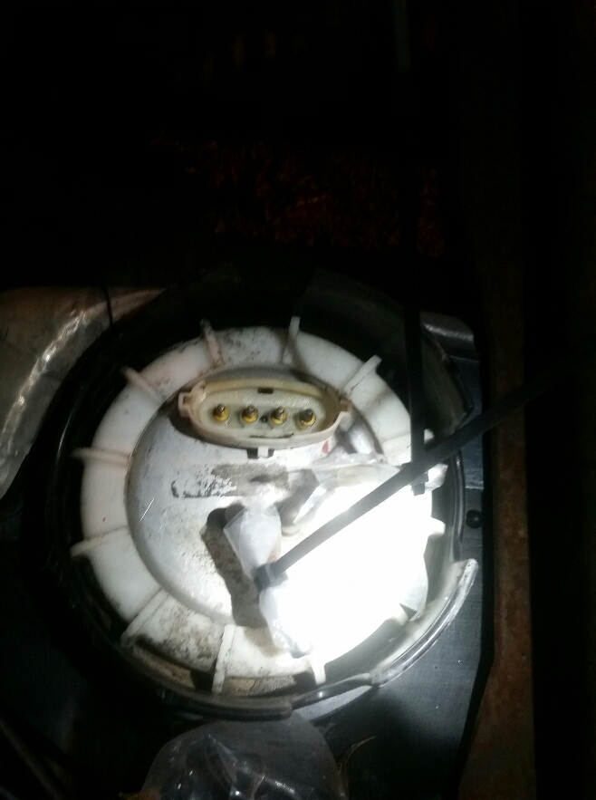

Here are a couple late night pics of the cover up of everything and a little look at the cleanliness of the tank area. Hopefully it is clean enough for the replacement process with as little dirt dropping in the tank as possible. Positive note is that there is almost no gas in the tank so even if I do drop too much dirt in, I can easily soak up the gas and clean out the grit.

The frame seems to be pretty sound and sturdy with very minimal rust(surface only as far as I can tell). Personally don't think it really needs the in depth restore but I am not a P&B guy but I have seen other vehicles in way worse condition to require that type of work.
The tank looks good to go with the parts swap...and the frame will probably last a long time ...I didn't pay attention to your location until TomW pointed it out...it makes a huge difference where you are and what they put on the roads.
Although it doesn't hurt to do a bit of extra work when you can to try to make it look better and last longer it sometimes is a trade off...in Canada we use sand and salt or other materials to keep the roads from icing over and that stuff is very hard on metal frames and other parts...
Anyway, keep us posted on your progress...:)
First pics I've seen of a later model sending unit setup. Big plastic retainer instead of the 'interrupted thread' twist locker of old. Need a BIG pair of pliers for that one, or a strap wrench. Plastic doesn't get 'glued' in place by chemical/oxidative action, so it should come off readily. Looks as if you are read to go. I don't know what the book or instruction sheet says(if there is one) but whenever I've had plastic fasteners like that, they indicate to use 'hand tightening only', or 'tighten until snug, then go 1/4 turn' or similar. Do not get too wrench happy or you'll be taking a trip to find a new 'ring'.
