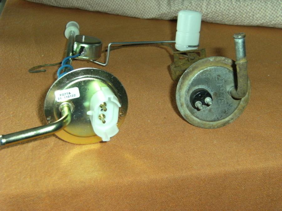

Picked up the unit today after work. Here are the pics of the 2 side by side. about 1 & 1/2 inches longer but that is easy to fix. the plug is a bit larger but can easily fix that also. the main thing is the size of the flange being the same to make a tight seal on the tank.

Just finished bending the tube to sit at proper height, slipped back on the plastic filter, bent the float up a bit to register at the right area and popped it into the tank. fits like a glove. haven't tightened it up yet, will wait till it is being installed to the frame to just be sure I won't need back in there.
So glad this worked... if anyone else does this too, GO BUY A PROPER TUBE BENDER ... if you don't already have one that is.... last thing you want to do is kink the pipe, it takes a bit of pressure to bend, and also do it in small increments testing as you go and shine a light into the tank while looking into the tank, to adjust the float Angie held the unit for me and I took 2 vise grips to slowly bend the rod into the right height above the bottom.
