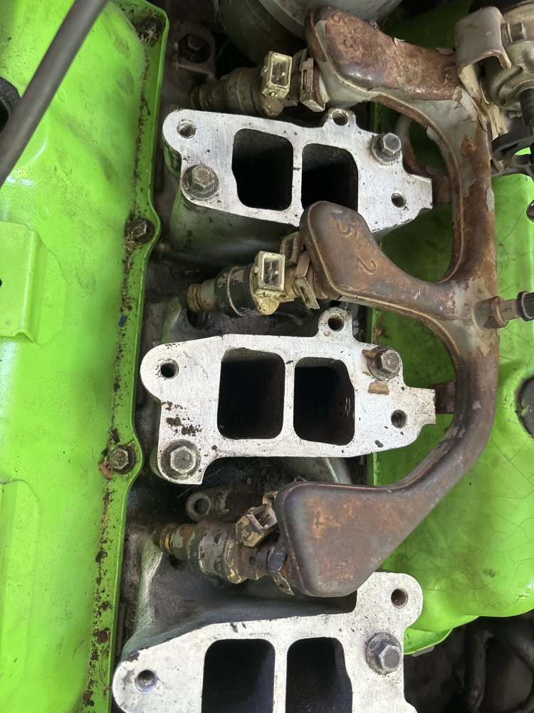

I’m putting the fuel rail back in my engine but I can’t get it to go in. Do I need to take all the injectors off the fuel rail and put those on first?
Logic says that either way the same difficulty in regards to force. Also says that it's easier to line them up when hanging down. You can just let the rail sit on them and push them one by one into the holes in the intake. Have you used any lubricant? IDK about fuel rail o-rings, but we use dish soap on hydraulic fitting o-rings at work quite often.
we use crisco on fuel related o-rings when building turbine engines at work
