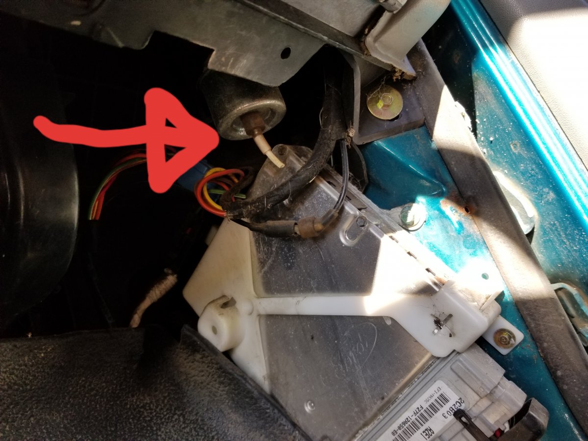

I was looking around the CPU a bit more and I saw a broken white wire connected to what looks like a small fuel filter under my glove box. Any idea what it is?

The white "wire" is a vacuum line. I believe it's for the blend door.
