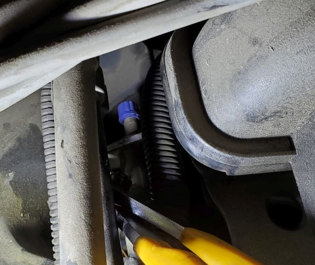

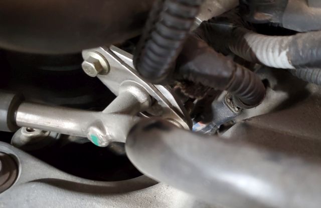

I greatly appreciate all the time spent sharing your thoughts. At this point, I feel to monitor this for a while. Thanks to "HawaiiMud" on another forum, I found the test fitting (it is on the back end of the passenger-side fuel rail -- see photo) so I'll get a tester and check the pressure. Assuming that is good, I'm going to wait and see if I have another instance of the "won't start after coming back out of the store". If that happens, I'll call it done and replace the fuel pump.
