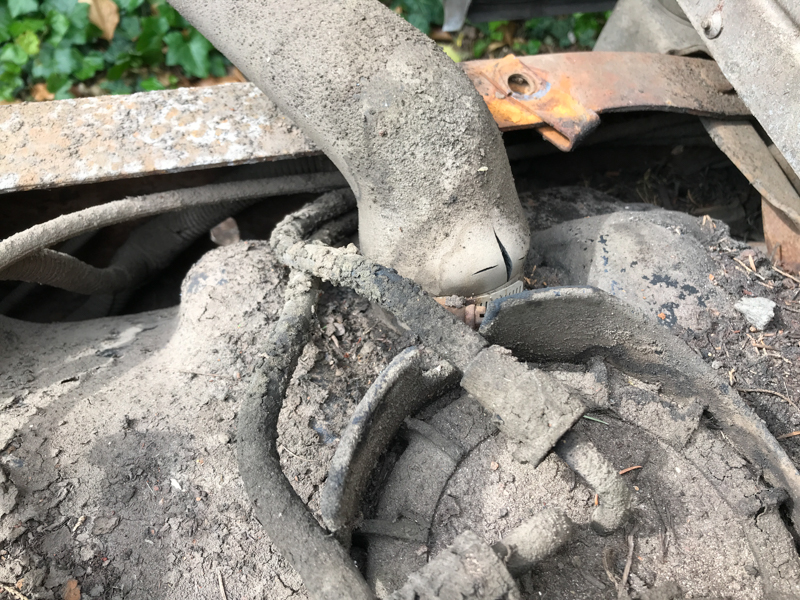

Well, y'all were right! Going to inspect it closer now and see if I just need to replace the hose or the whole neck. Thanks for the help Dirtman and RonD!
While you have it apart you may wanna check that none of that mud and dust made it into the tank from the hole.
Sure looks like that thing has been through a mud bog or 3...

Yes, Washington gets a little rain now and then, so underside do get dirty

I scratched some lines tracing where the filler neck was. Hopefully that will make lining it back up easier when I put the bed back on.
27971
The inner tube and fittings look good so I think I'll just order a replacement hose. Found this one on rockauto $40 shipped, not too shabby. The most time consuming part of this was removing some tar like stuff the original owner caked it in.
