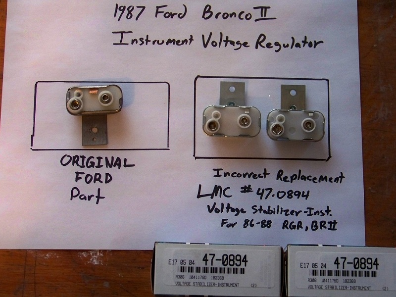

So far I've replaced the in-tank sending unit with a whole new setup (everything eccept the pump) cleaned the wire terminals at that end, and attempted to replace the instrument voltage regulator. The IVR was first replaced with one from the salvage yard, it was bad. Then I ordered one from LMC truck (part # 47-o894 instrument voltage stabilizer) The part they sent me was incorrect. It looked exactly the same, except the mounting tab was exactly backwards of the original, and would not hook up. I called them, they checked their stock, and then sent me another incorrect one. Now I have to prove to them with pics that their stock item does not match the original, as their information says.

Anyway, I'm trying to get my e-mail account to upload the pic I took comparing the two different Voltage stabilizers, so LMC will be convinced they are offering the wrong one for this application. (am I the only one who has had this problem?)

I'm trying my hand at uploading pics. This should be the Gauge Voltage stabilizer comparison, in case any one wants to see. Can't seem to get my yahoo account to upload it for e-mail....hmmm

I would bend the metal tabs and pull the guts from one of the new ones and stick it into the old housing or maybe just turn it around. I'm probably more impatient than you though. Makes you wonder if they just messed up when they assembled them.
I have been tempted to do exactly that. But at 50bucks a pop, I want to be shure the guts are the right ones. It could be that this design is for a different application. I may try to test them and see if they function the same. As soon as I finish my new bumper mounted spare tire carrier, I think I'll start on that.
I finally had to use my wife's e-mail to get the pic sent to LMC. Now I'm waiting for their response. Still can't figure out what's up with my yahoo account. It just freezes up every time I try to upload an image.
