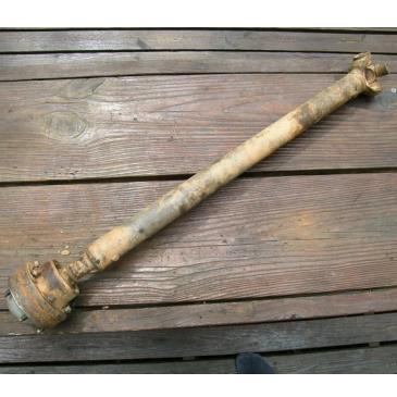

I was planning on doing this driveshaft conversion, and think I have all the parts for it now:
Well, pulling the front driveshaft got rid of all extra noise and vibrations. The u-joint was no too good in it. Think I will end up just putting a new u-joint in the original shaft and re-install. Scared of making big changes just before winter and the upgraded driveshaft is a bit worrisome to me. Probably put it in next summer.
That output flange (yoke) on the front of the transfer case does not connect to a U-joint. At least that is not what is on mine. It is a CV joint and not easy to replace. Mine went bad because the boot cracked and slung out the lube. I wanted to replace the CV joint but realized it is better and not much more expensive to replace the entire front driveshaft. It is your call though.
a dry ball in the cv joint can cause all sorts of really bad vibrations. the joint must rotate smoothly.
I had one start vibrating and found a dry ball, slathered some fresh grease in there and it only lasted a day or 2.
replaced the shaft with a reman one from NAPA.
