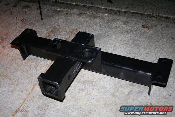

Here is a pic of my 94. I had a guy fab it up. Simple, just weld in a cross brace between the frame and weld on a 2" receiver bought from Tractor Supply. Also weld in some supports to beef it up.
^^^ more pics of this please. i hate how low my bolt on one hangs

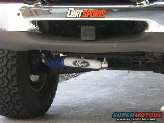

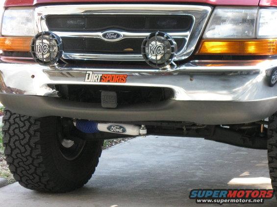

I added a Reese 2 inch front receiver some years back to my 99 Ranger. You never know when you are going to need one. Mine has come in handy a lot of times. The 98-99 year has plenty of room to add one. I never thought about where to put them on the earlier years until now after I saw the photo and the lower valance.
^^^ there so much more room on the 98+ trucks for a front receiver
