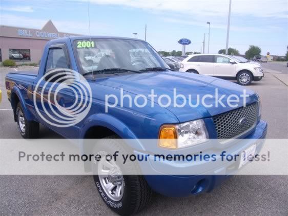

Can't tell you right now how the supports are put in or if common between what years. Here is the '01' Edge with the grill you describe. Sure there were still around in '03', sure sorry I got rid of this one.
