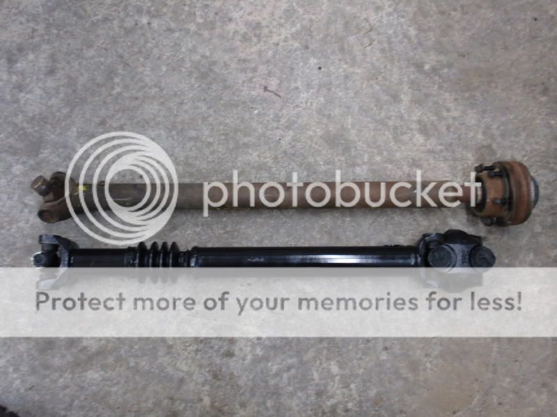

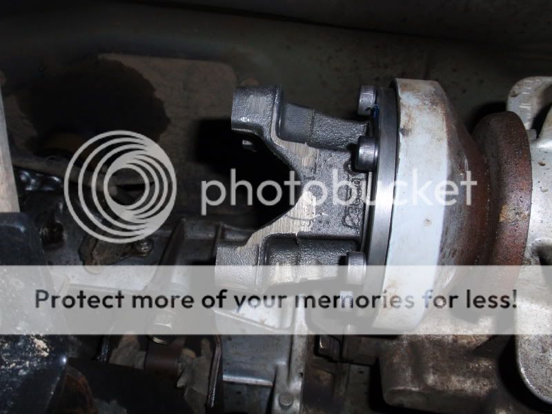

Here's what I did...(info is revelent to your problem...) AND the joints are all serviceable. If you ever plan on putting on a suspension lift, you've already got your shaft.
Make one....or have one made for you.
I made mine from a 95-00 Explorer front shaft. Shortened it a few inches. Used an adaptor. All my parts were brand spankin' new and cost me right under $300. Can be done easily for significantly cheaper using a junkyard shaft and not a brand new one like I did....
$50 JY shaft
$50 shaft shortening
$80 adaptor
$180
What I built, is exactly what superlift sells that is priced upwards of $500 for.
here's the build up of my shaft and another persons shaft, but you've gotta join...I really suggest joining Ranger-Forums...

I need to do the same thing to my 1998 ranger.....where did you buy the adapter that makes it go from CV to UJoint on the T-Case?
Got mine from a local driveline shop...ended up being the incorrect model(was a model that was on the shelf for 10 years! lol.). I had to have machine work done to my adaptor to make it fit properly. I needed it now and and no time to find the right adaptor. 2' of snow came the day after I put on my new front shaft... Click my link I posted. Join RF, and view the thread. Later in the thread, the correct part numbers were posted, with links to diagrams of the EXACT part Superlift includes as part of the front shaft...
Neapco is the brand...go to their site and call them up for a local driveline shop to you.
