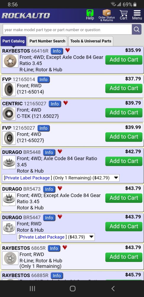

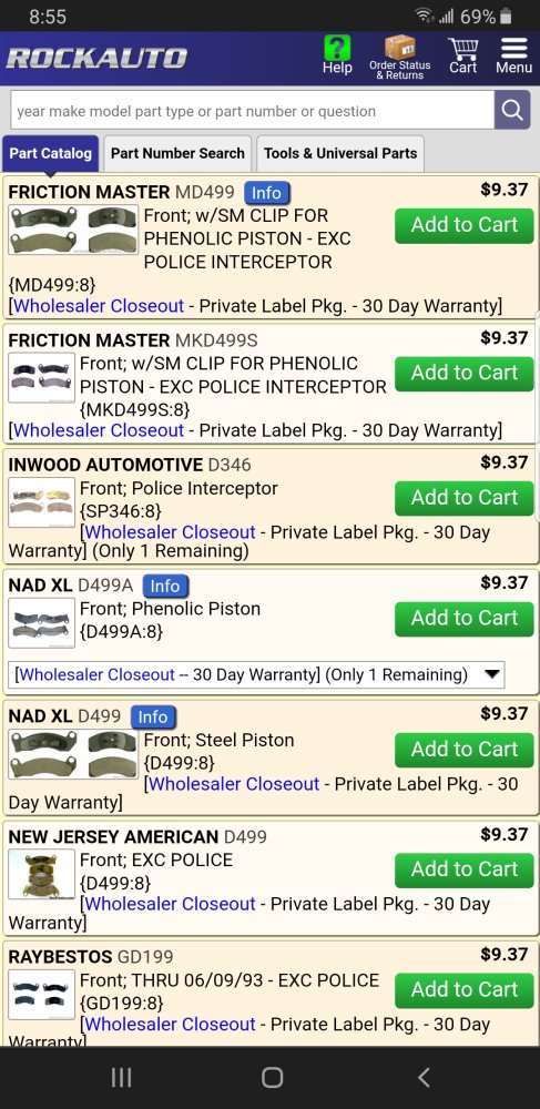

Can anyone advise. I need to replace my Front Disc Brakes and a Rotor. I have a 1993 Ranger 4x4 4.0L. XLT Super Cab.. I'm confused on which brakes and rotor to purchase. On the Rock Auto website it's saying Steel Piston and or Phenolic piston. I'm not sure what that means. Photos enclosed. Can anyone advise which Rotors and Front Brake Pads I need please.
How do I know if I have Steel or Phenolic piston.

To know for sure you would have to remove the caliper then pads and look at the piston.
Not sure I've ever anything but steel pistons on a Ranger. Also appears that yhe police package gets the phenolic piston.

Rotors:
3.45 ratio is only available from Ford with 3.0 engine. As you have a 4.0, not applicable. Uncheck RWD and unspecified and you have 5 choices varying by about $15..
Pads:
Ford used same pads in Aerostar, Bronco, Crown Vic, Econoline vans, Explorer F series truck and Ranger in '93.
Ignore the Police Interceptor and Phenolic piston ones - they are for Crown Vics.
You can go more aggressive with semi metallic pads if you want. (Be aware they will wear rotors faster.)​

Rotors:
Pads:

The phenolic ones are a hard plastic material more susceptible to heat deformation than metal pistons. Of the three gear ratios offered , 3.45 3.73 4.10. For whatever reason the 3.73 geared trucks got 2 1/2” thick rotors. The others are 2 1/4. That’s measured laying on a flat surface to the top of the bearing race
