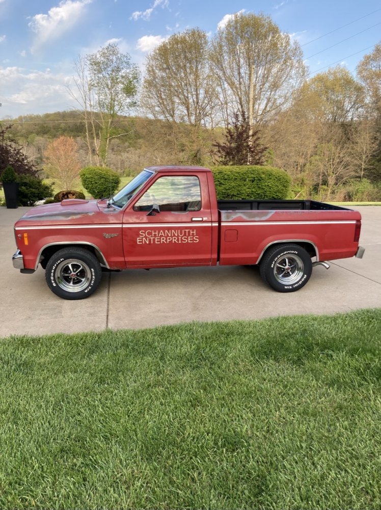

Heavier Springs will definitely raise your ride height a decent amount. I’ve got a V-8 swap in mine and didn’t do anything to the springs and it lowered it about 3/4 of an inch and I think it looks much better that way. I also added 150 pounds of weight under the bed for traction but it also lowered the truck about an inch in the back and I like the way it looks. It still has a nice soft ride but I added anti-sway bars to the front and rear and it corners nice and flat.
