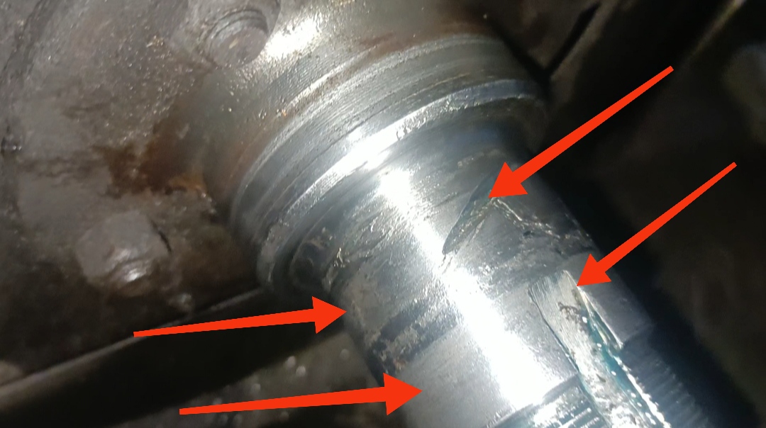

I have manual hubs,1994 ranger 4wd.
My question is, do I need to grease the spindle surface under the bearings seat's?
The spindle itself is somewhat damaged from use, as it happens. The book says it should be a thin layer, knowledgeable people say it should not. In the end I assembled the spindles completely dry, without grease, but well lubricated the bearings themselves.
Should I leave it like that, or should I redo it?
This is the point I'm talking about.
I'm afraid about overheating between bearing seats and spindles..

I think you're misunderstanding me.
My question is, do I need to grease the spindle surface under the bearings seat's? The book says it should be a thin layer, knowledgeable people say it should not. In the end I assembled the spindles completely dry, without grease, but well lubricated the bearings themselves.
I wouldn't worry about it. The bearings were greasy when you slid them on.
It's more important that you cleaned and inspected them before you assembled them.
I tried to wipe the inner cages of the bearings (with which they touch the spindle) dry as well))
Ahh, my mistake. It doesn't bother me to have some under it, I have never paid it much mind but I also use no measures to prevent getting grease all over them. I don't think they really need it, but also use no measures to keep it out.
The primary target for the grease is the bearings, and as I add the pieces putting it together sometimes I'll push a bit more in there before closing it up.
You also have manual which I am not educated in so any objections to what I've said may be reason to investigate farther
Well... the inner race doesn't spin. Therefore no lube is needed.
I typically wipe the spindle clean. File/sand any imperfections. Pack bearings... assemble. I don't think I ever purposely smear lube on the spindle. I do wipe a bit of grease on the seal lip to lube it.
I think you'll be fine... but if it bothers you... do it again.
It keeps me on my toes)
Anyway, thanks u for your answer.
In theory, you'd want that dry to keep from spinning the race on the spindle. That's what usually damages the spindle.
That said I always have grease everywhere except the rotor surface.
