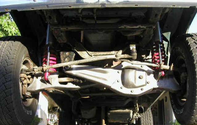

"Solid axle" refers to the type of suspension you have, not the type of differential.
This is a solid axle:
Notice how you have one solid beam, which has the wheels connected on both sides.
Bronco IIs have independent front suspension, shown here:
Notice you have two separate axle beams, one for the driver's side wheel and one for the passenger side. The beams pivot up and down when you go over bumps, and they can move INDEPENDENTLY of each other. Hence the term independent front suspension (IFS). Note: there are a few different types of IFS, this one in particular is called "twin traction beam." It's pretty much a Ford-only system, used on most Ford trucks from 1980-1997. Most other IFS trucks use an SLA front suspension (That's a Google term for you.) Hope this wasn't too detailed. Read it over slowly a few times if you have to, it'll sink in eventually.
