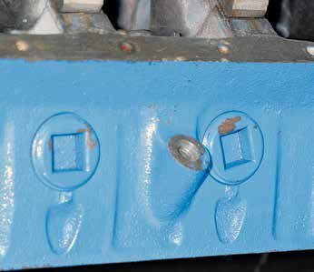

So the freeze plug popped out of the 5.0. Has anyone ever seen this before?
Yes, +1 ^^^^, seen it before
If its hard to get too use a rubber expansion plug to replace it, works the same to plug the core hole, just more expensive than the metal hammer-in type
I haven’t seen it. But I’ve heard that’s what they do.
Ok I wasn't sure if I killed her normally that happens when pressure gets in there. But it runs fine and the oil looks clean and isnt mixed in
It shouldn't be too bad its in between cylinder 1&2
Those are supposed to keep the coolant in. I wouldn’t run it until it’s fixed. But that’s just me.
