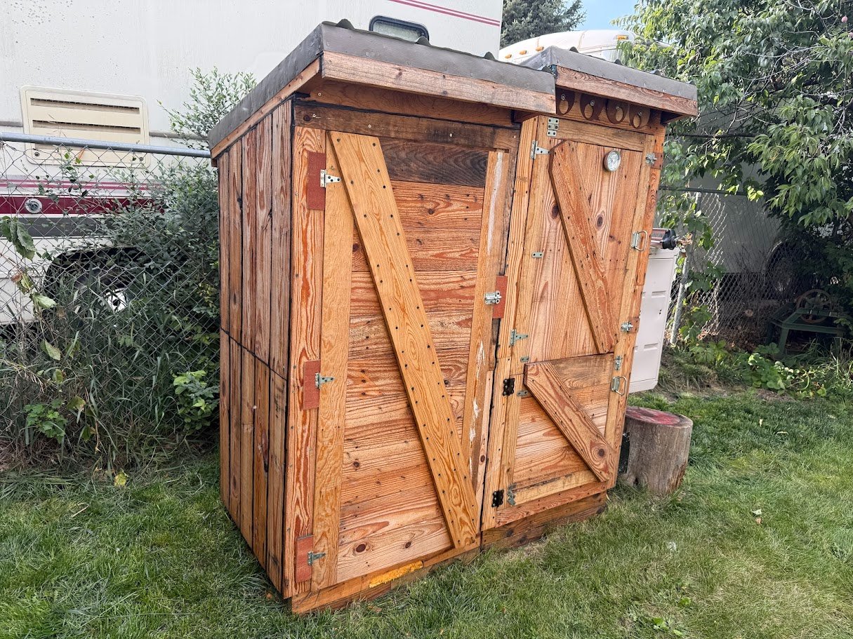

Takes about a year but it shrinks. I used it on my smoker between the boards instead of caulk, because I had a bunch of it on hand. I need to redo it. I thought I squeezed enough in the gaps but it dried & shrank quite a bit. The wood may have shrunk a bit too. It seems to shrink on metal roofs as well where I have used it.
You can kind of see how I used it here on the left side between the boards. If it's applied in a thin layer on metal, it might be fine. Maybe try it on a small spot and check back in a few years. I think there are better products out there.
