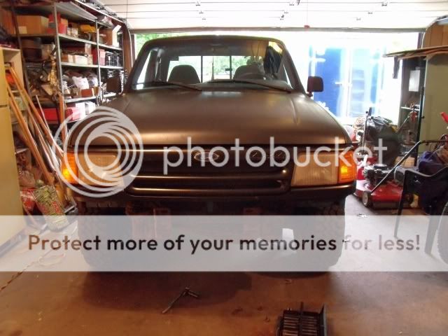

heres what my 93 looks like without the front bumper to give you an idea
hmm, looks similar to my cousin's exploder that he used to have. newer then ttb tho. ill have to remember what i did to mount the bumper i built for that thing
