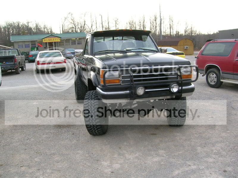

found this around the corner from my store=92,sas

92 ranger,4.0 5-speed,SWB,SAS with 90k on it.
looks like a early bronco front and rear.
power explorer seats with console.
they are asking $3500 for it.........worth it?
doesnt look like a hack job at all,what do you guys think?
Nice truck...I'd consider it...after a bit of testing...only thing I don't like is the cab...too small for me...
looks like i nice rig. i would ask to take a test drive first to see how it handled and if there was anything wrong with the drive train
The upper steering arm looks like its part of the original ranger steering. the radius arm drop brackets look flimsy and lack the cross member that originally came on vehicles with this style of suspension. If it has 260 joints on those front shafts and not 760Xs they are actually weaker than the d35.

but a TTB 35 has 2 more u-joints to fail.if thats what you are referring to....

don't get me wrong 86.i do respect your opinion and i want it...
Should be the Mazda 5 spd.

One of the sharpest lookin early 90's model Ranger's I've seen.......I'm personally not real fond of the gen 2's, but as I said, that's a good lookin rig......BUT, it needs a V8!:icon_twisted:
That truck doesn't look too bad on the surface from what I can see, but I agree, those radius arm drops could've been done much better (those things are land anchors). You got any pics of the trackbar bracket and where it's welded to the frame (hopefully reinforced to the engine crossmember)?
Also, are those bolts I see missing out of the front diff cover? :icon_surprised:

TTB has one more u-joint (and it's in a position that sees less stress, making that joint less prone to failure).
No question the D35 is most certainly a stronger axle, unless the EB axle has had it's shafts upgraded, then it could be a much closer call between them.
Yes, Mazda M5OD on that truck if it's a 4.0L

thats the eye i was looking for,didnt notice the bolts missing.......but they are!
and i stand corrected on the u-joints from the TTB man.......:owned:(if you want to keep your TTB alive listen to this guy)
i think monday iam going to drive this pig and see whats its hiding.
i already have one with a v-8:icon_hornsup:....iam looking at this for a DD:icon_thumby:
Is it me or do I see rust bubbles under the paint on the door. Upper right hand corner next to where it says "RANGER.":icon_confused:
