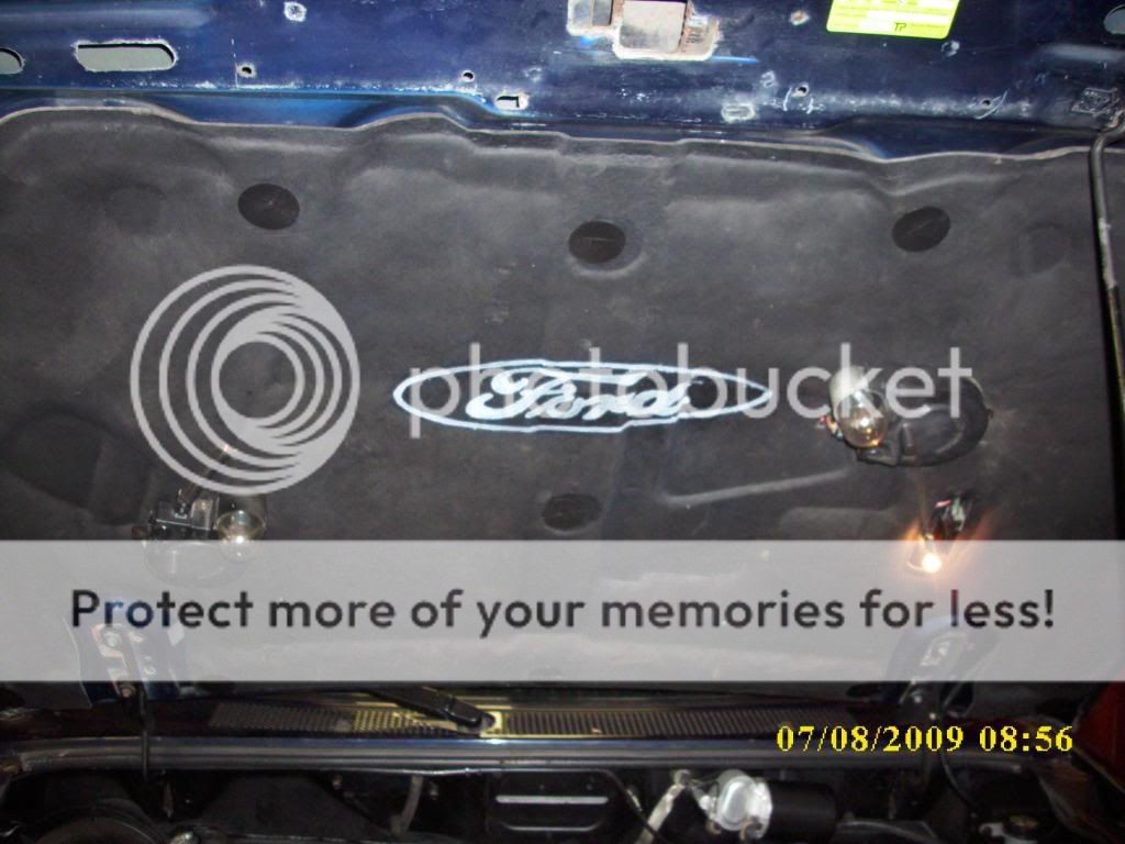

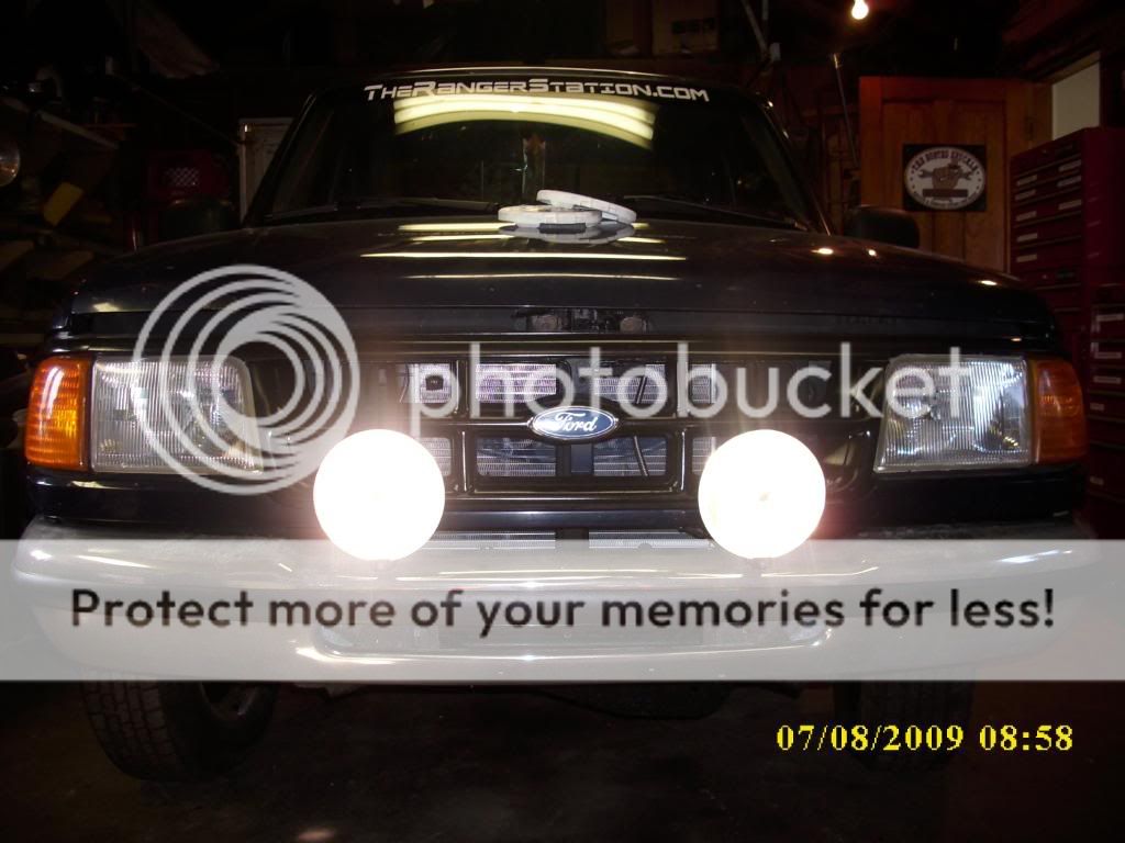

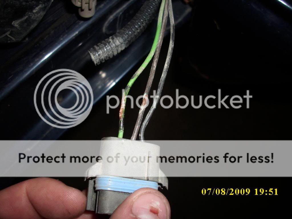

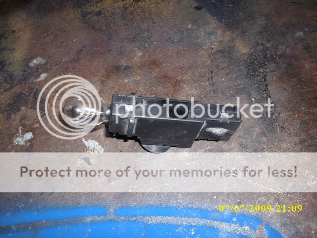

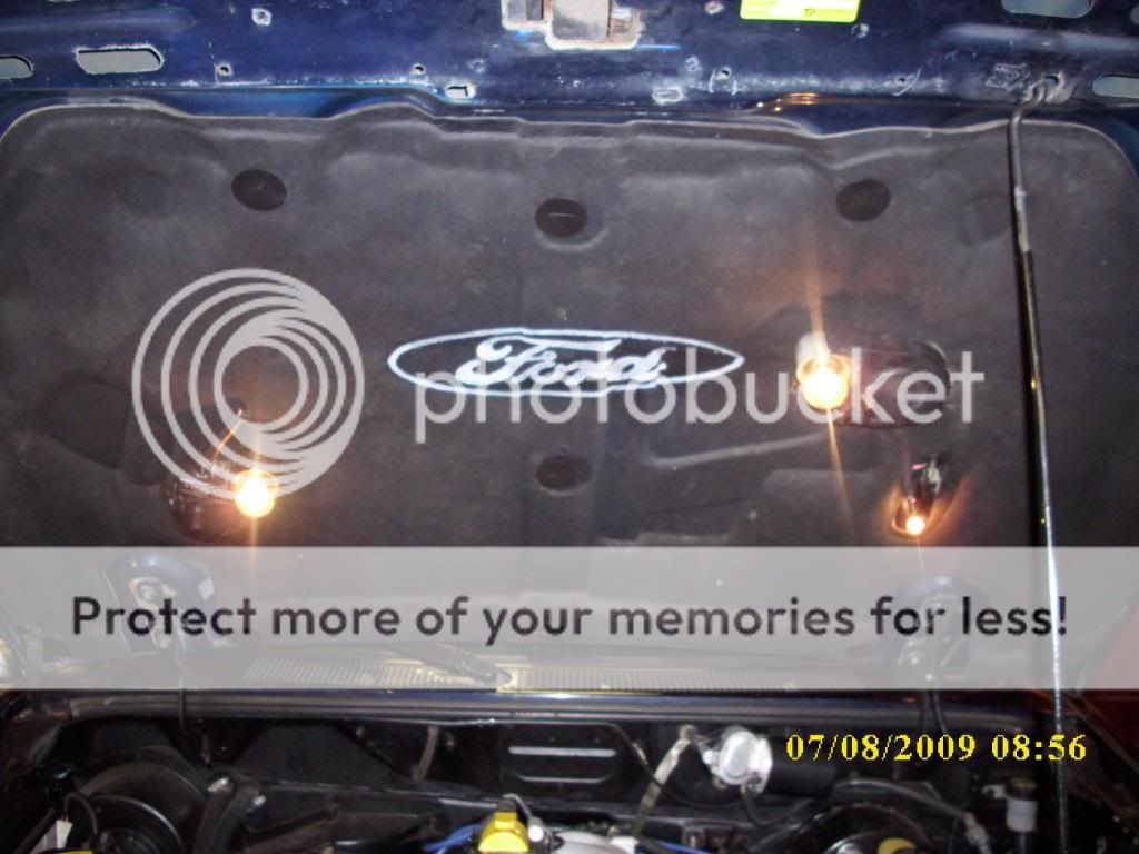

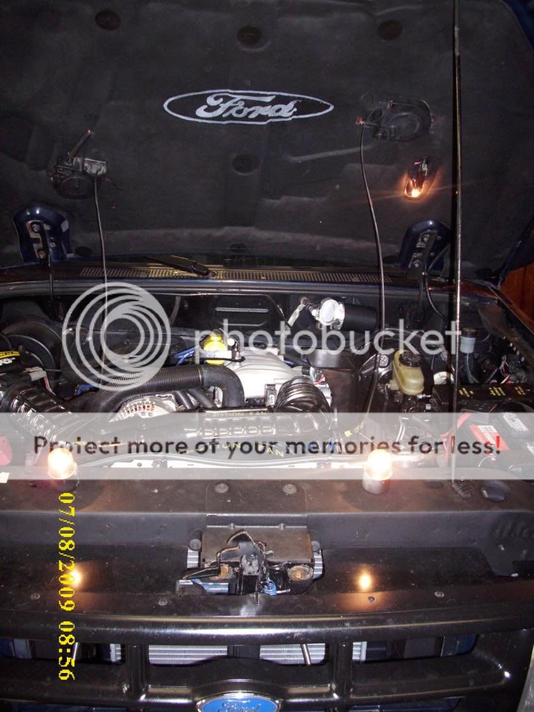

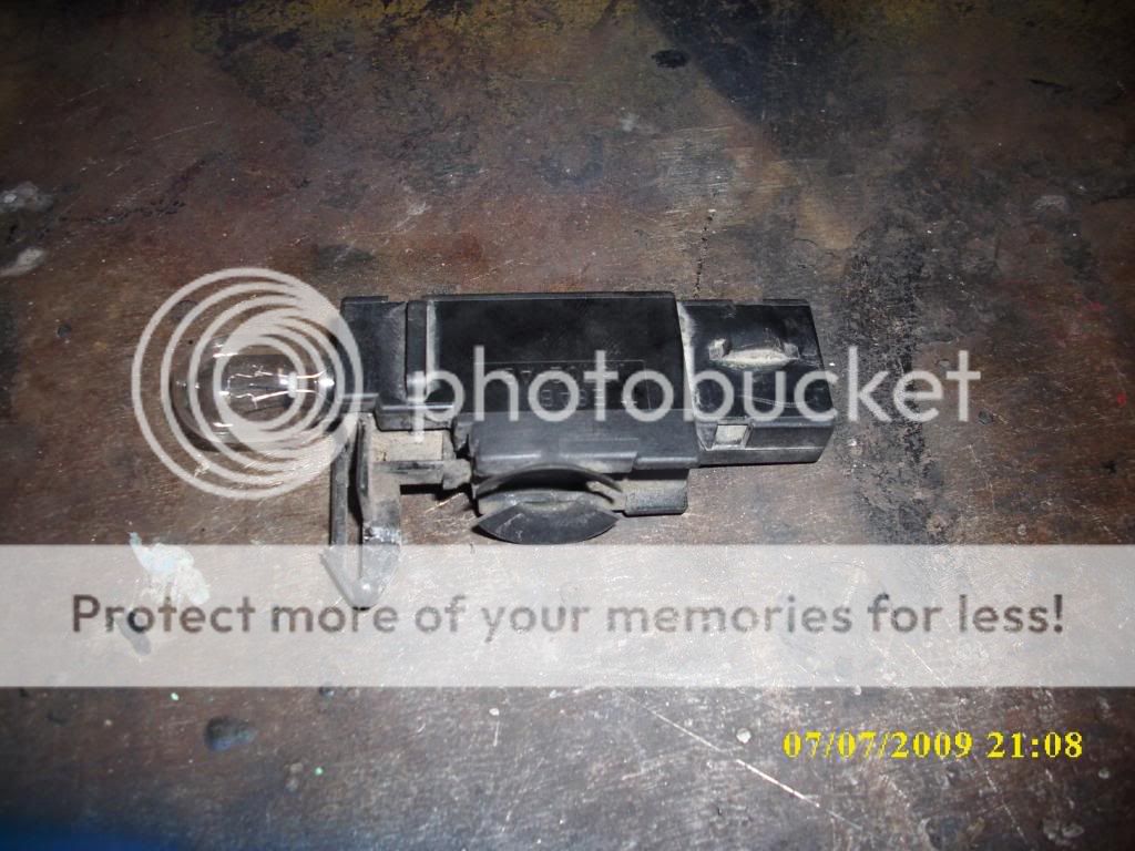

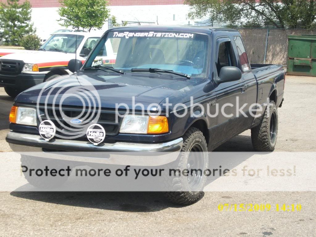

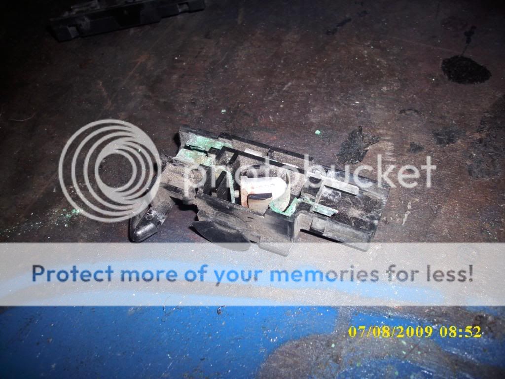

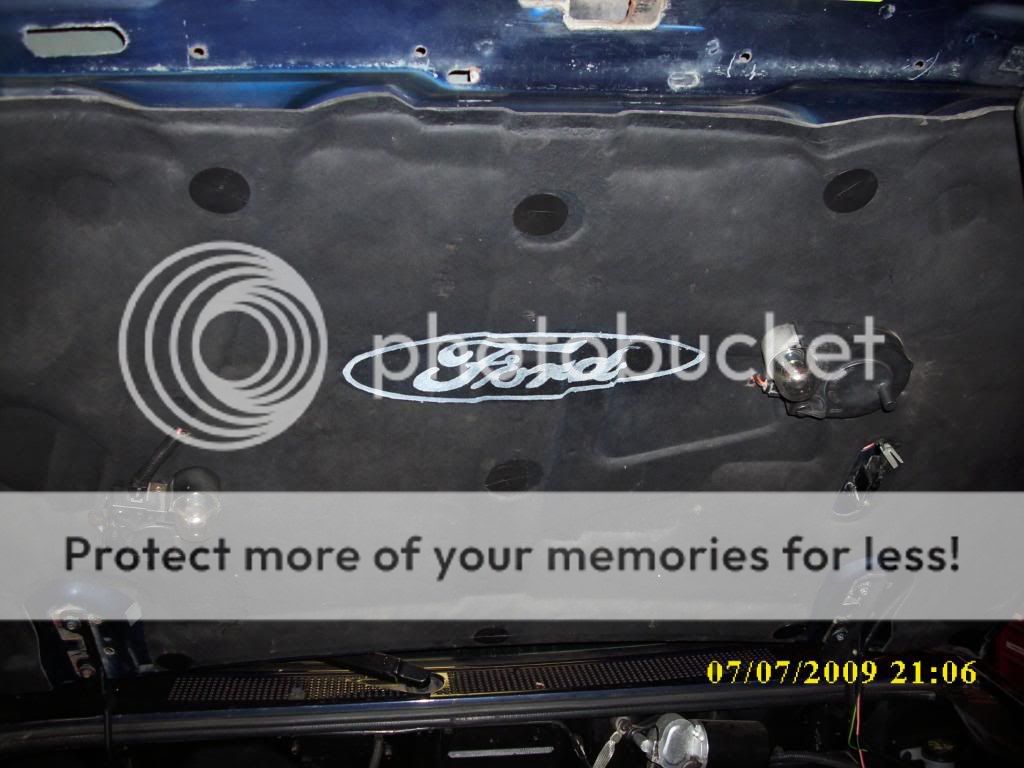

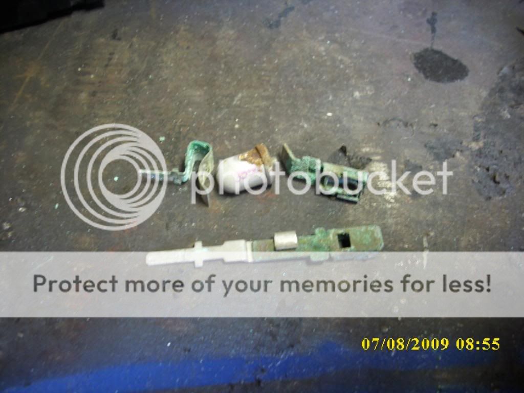

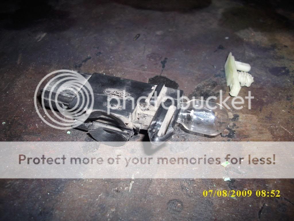

the lights are wired up now and fully functioning. i also ran the power wires for my hellas and they also work now. i took some pictures of the OE hood light as i disassembled it so i could make it work again. i was thinking of writing up a tech article for this becuse its a pretty common problem among rangers, but my ambition is mainly focused on the truck right now. heres some pics:

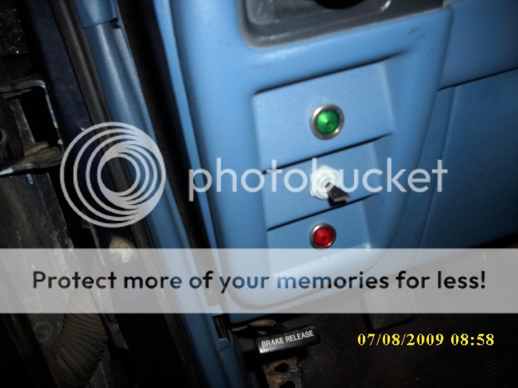

i got another toggle boot for my dual battery switch and think it really finishes it off nicely.

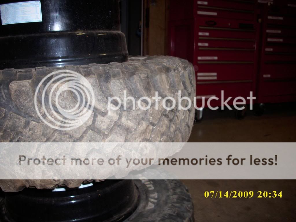

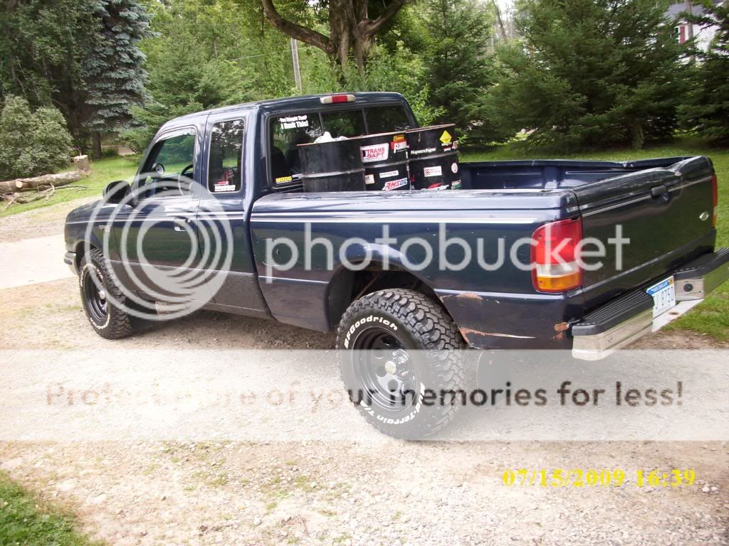

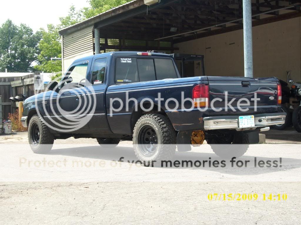

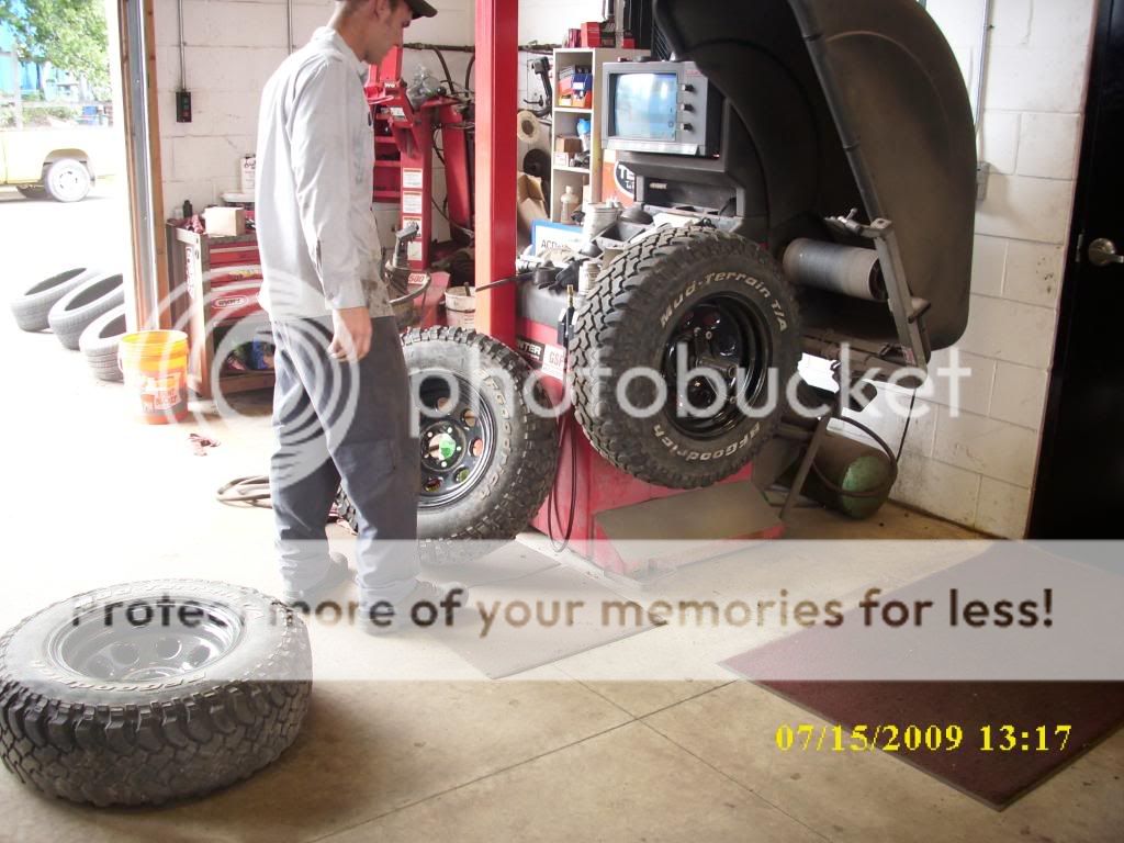

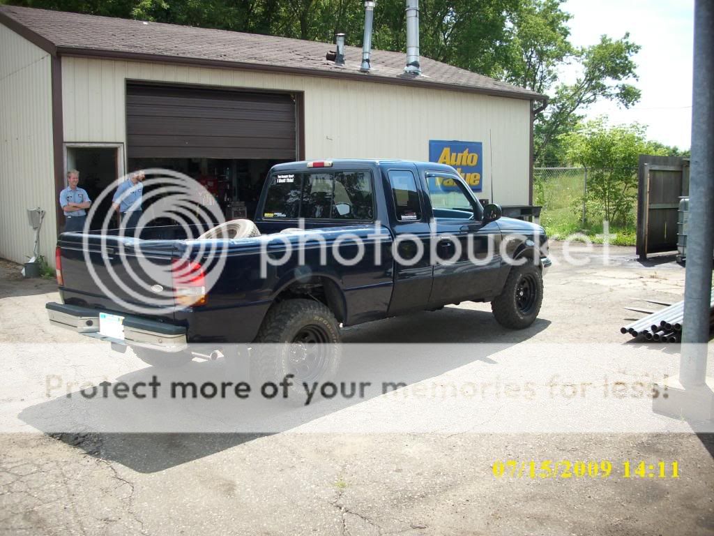

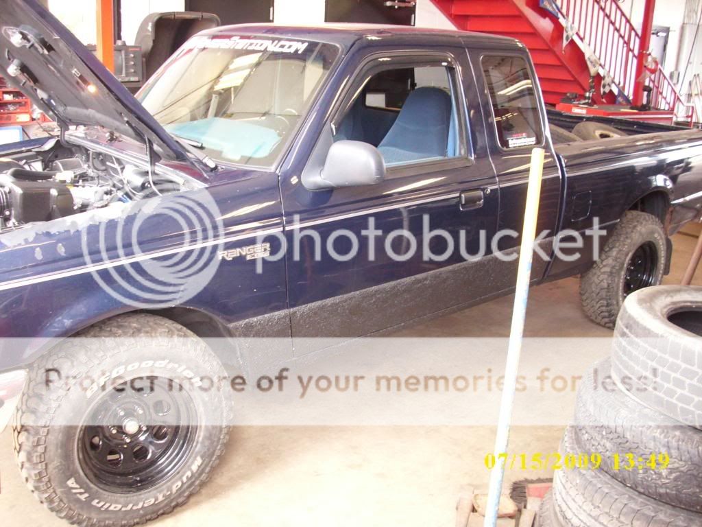

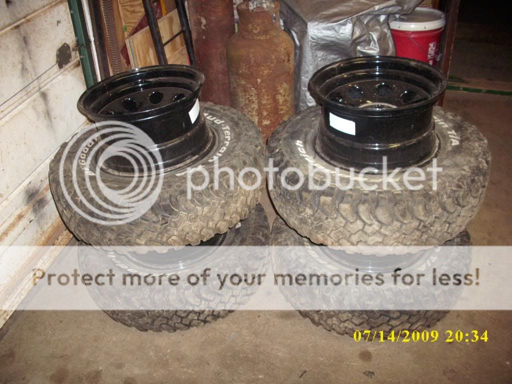

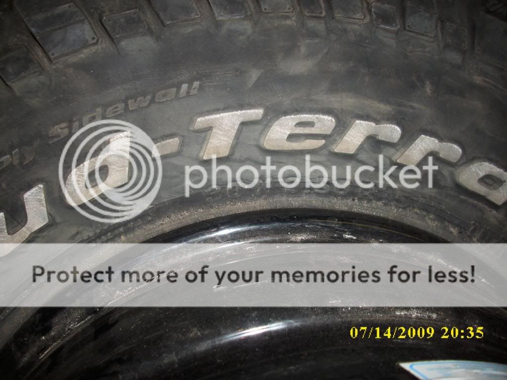

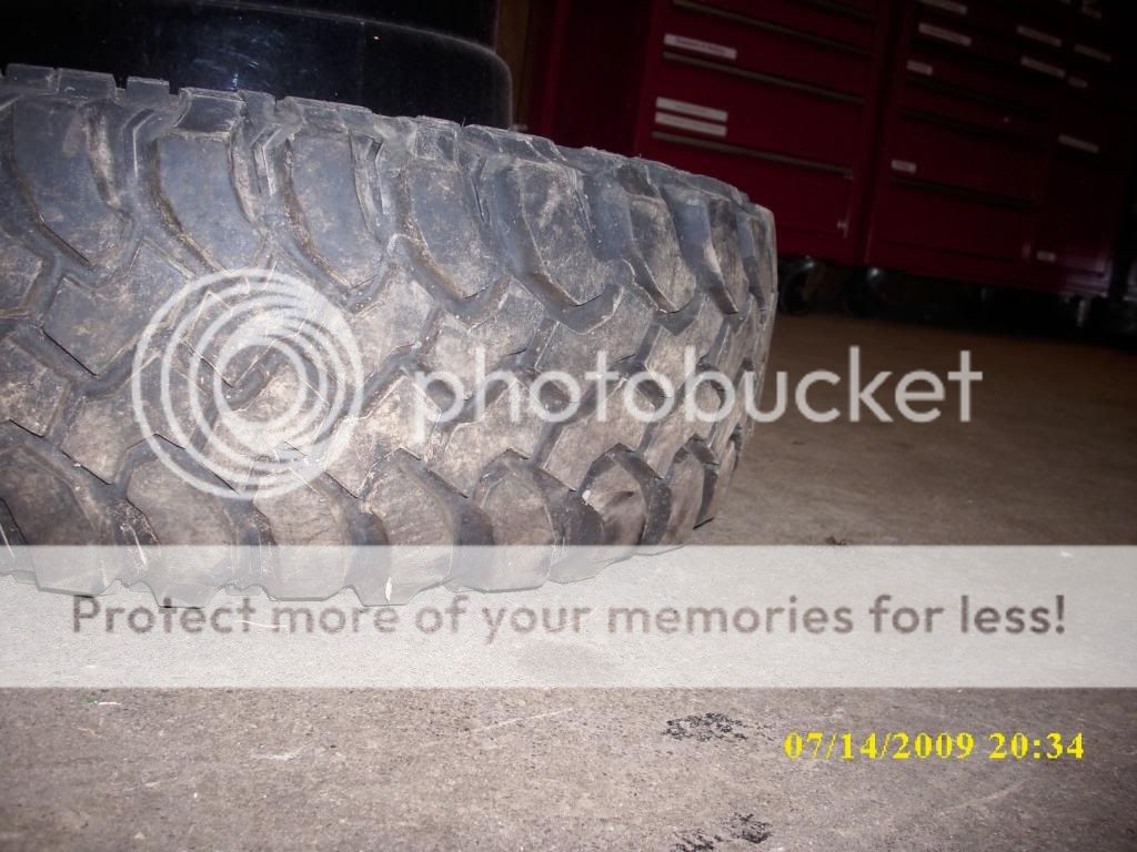

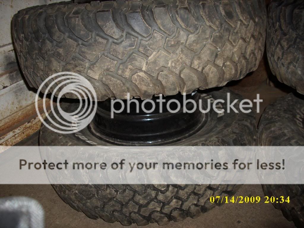

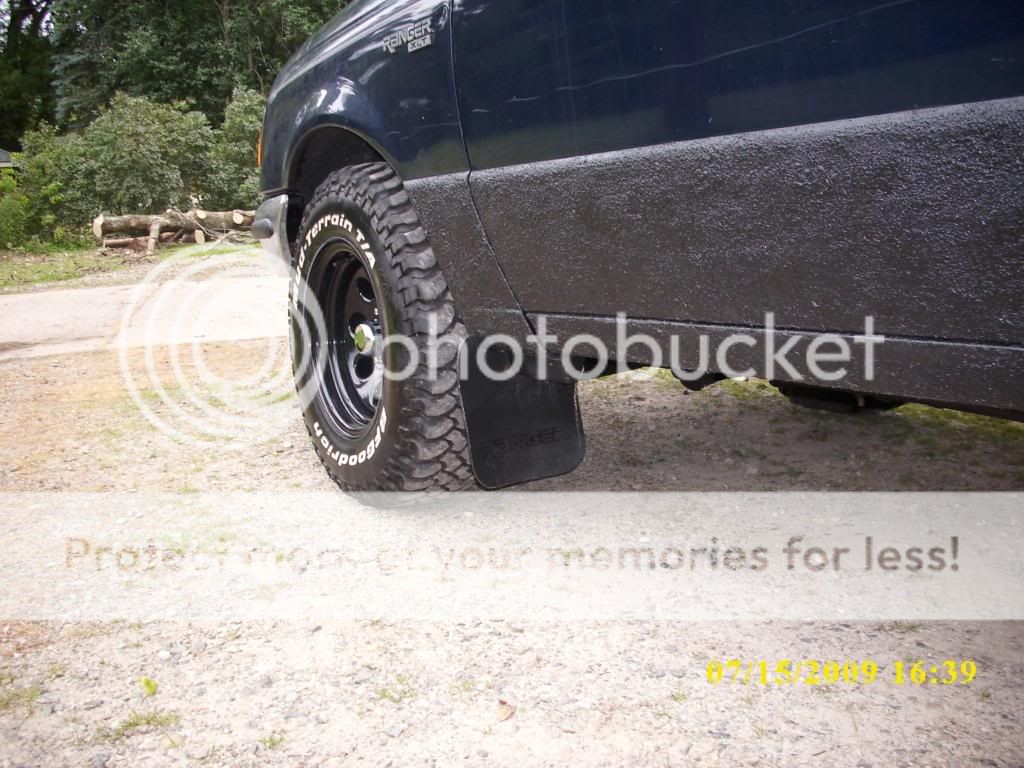

last night i picked up a set of 30 x 9.50 x 15 BFG mud terrains from a friend for $100. im having them mounted today and hopefully they will clear the front fenders and wheel wells just fine, otherwise im going to be staking washers until i get the desired height and then ill weld the washers together and POR15 them. heres some shot of the tires

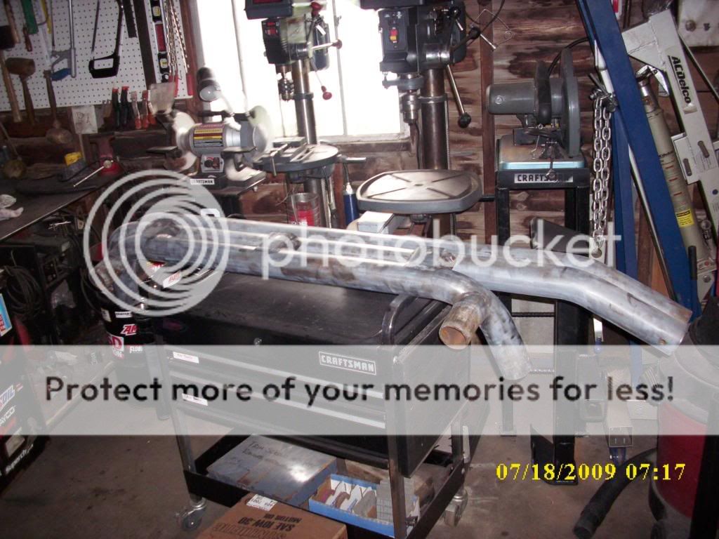

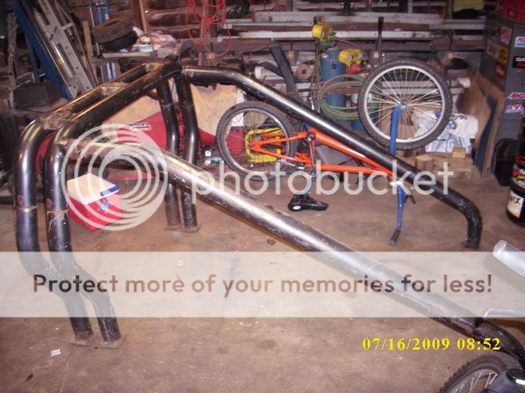

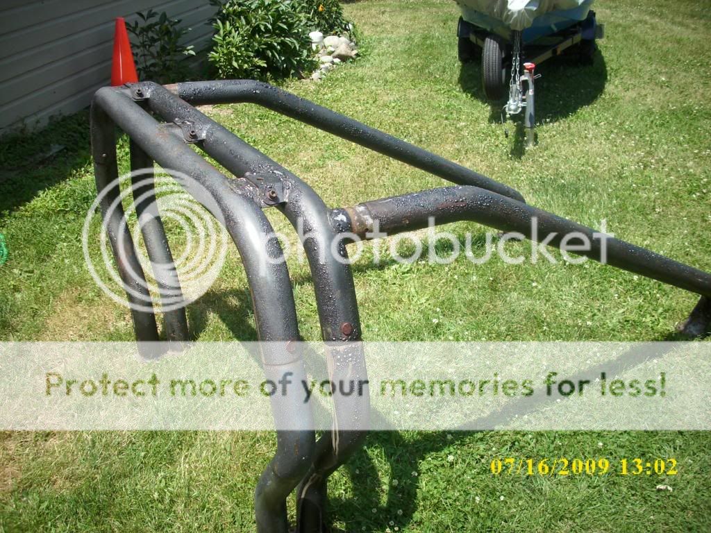

i went home after taking the pics at work and washed the tires and wheels and also put on the chrome center caps. on my lunch break today i started stripping the paint off from the roll bar. my plans for it are to clean it up, position it in the bed and make my marks, then weld all the joints on the cage and build mounts to attach the bar to the frame through the bed. it sounds kind of confusing but ill post pictures when i get there.
damn that paint is stubborn! i used up two cans of this stuff http://ep.yimg.com/ca/I/sjdiscounttools_2060_62170914
and i scraped paint for 2 hours and still hardly put a dent in this project. i think i may end up taking it apart and putting the pieces in the oven at work and just baking the paint off. my other thought for the week was about my bent up bed. i think that if i place 2 or 3 C-clamps on the bed rail and then use the engine hoist to lift up on them i may be able to get the rail relatively flat, at least good enough to finish herculining the top and bottom of the bed and get this thing legal!

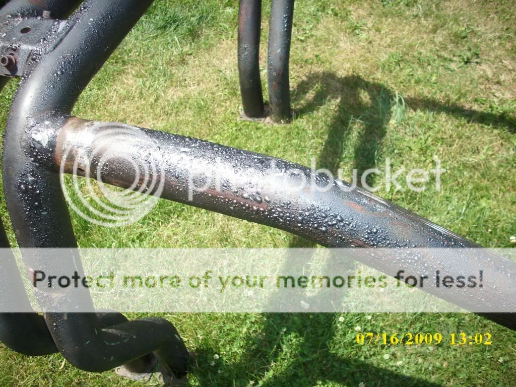

when i got off work last night it had cooled off, so i put on some long pants and a long sleeve shirt and got out the makita grinder with a wire wheel on it and heres what i got
All it took was a little elbow grease to get that paint off (although im sure the SEM helped)
